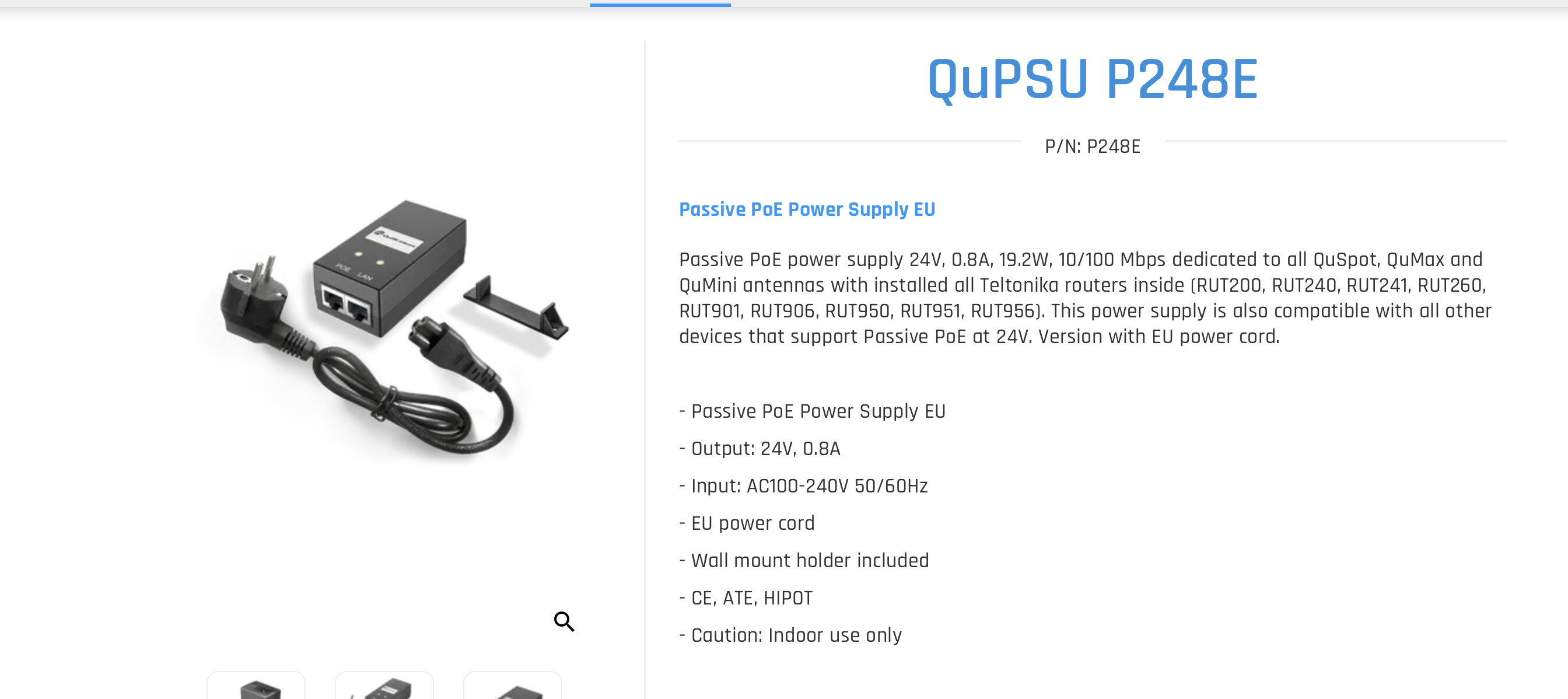

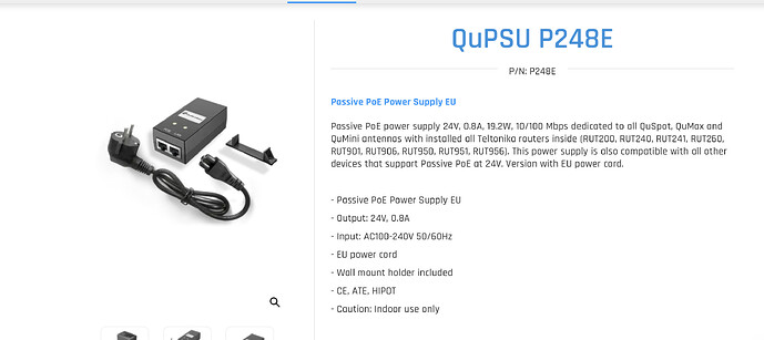

I’ve found QuPSU P248E but problem is this is AC powered.
Assuming you can power the RUT241 device via LAN1 port ONLY using Passive PoE ONLY, and and mindfull of its maximum power consumption, then the Mikrotik RBGPOE-CON-HP PoE Converter (active to passive), should be more than enough for you.
So how do you intend powering the POE?
