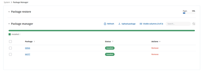

After upgrading RUT906 to 7.14 the package manager not working.
I had some packages installed before but after upgrading to 7.14 they just went to qued.
But never got up and running.
I was able to reinstall the packages by downloading them to the computer and install from file. After that they where working.

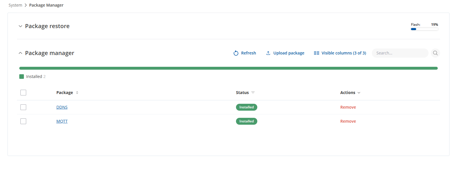

But I cant install anything from browsing the packages because there is now packages when i try to search for them in the package manager.
Do you mean that no packages are appearing in the WebUI?
If so, please check whether your device has an active internet connection. Packages in the Package Manager can only be installed when the device is connected to the internet.
Only the packages that I had to download my self are available.
Could you please check if your router has an active internet connection?
This could be through any of the following:
  • An Ethernet cable connected to the WAN port
  • Mobile WAN (SIM card)
  • Wireless WAN (Wi-Fi as WAN)
