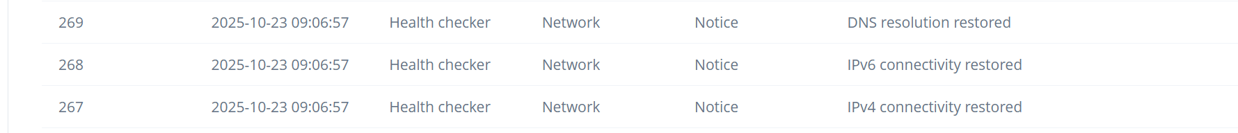

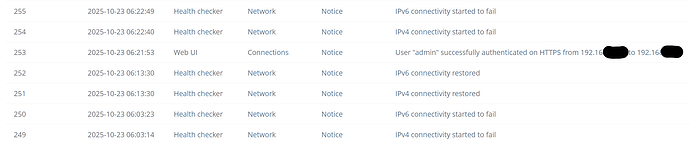

i do get these failures 1-2 times a day. After rebooting the device it’s working again.
My usecase is as a simple outdoor modem. On OTD500 Lan1 I’ve connected a FritzBox 7590AX on its WAN port. The OTD500 DHCP gives the 7590AX an IP on WAN, whilest the 7590 builds up its own Network behind.
Overall speed is good until the failure happens, then tho whole network doesn’t work anymore whilest I’m able to ping e.g. 1.1.1.1 or 8.8.8.8
