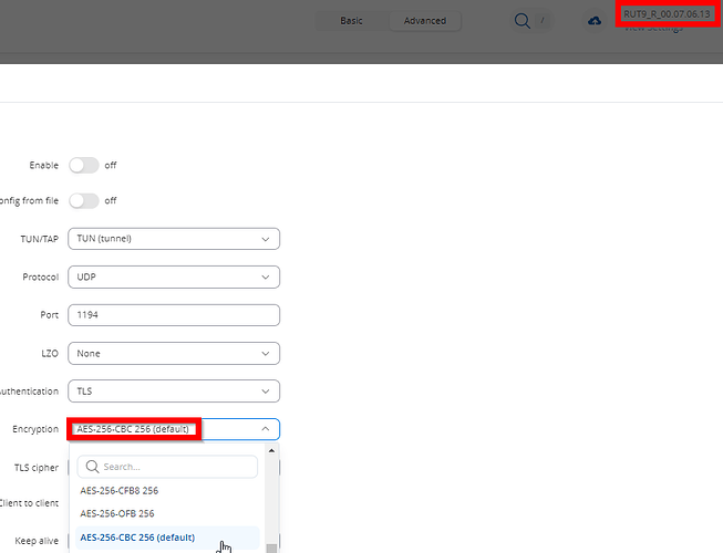

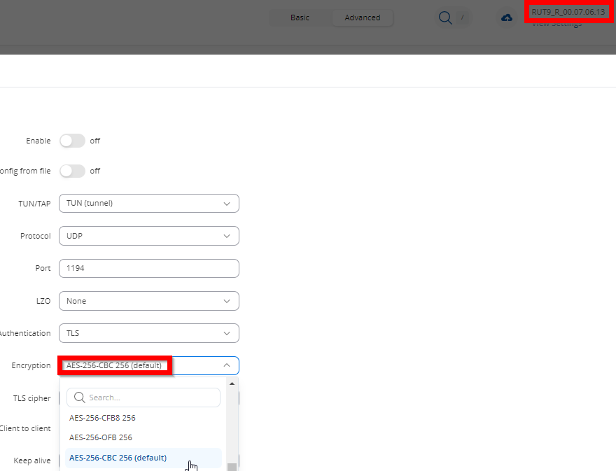

AES-256-CBC encryption should still be used for version 07.06.13 and later. It was not removed, and it remains the default encryption algorithm.
Hi Marijus,
yes, I can see that in case I want to add a new Client. Therefore the chiper is available.
But where is
“DEPRECATED OPTION: --cipher set to ‘AES-256-CBC’ but missing in --data-ciphers (AES-256-GCM:AES-128-GCM). Future OpenVPN version will ignore --cipher for cipher negotiations. Add ‘AES-256-CBC’ to --data-ciphers or change --cipher ‘AES-256-CBC’ to --data-ciphers-fallback ‘AES-256-CBC’ to silence this warning.”
coming from?
Where can I find the OpenVPN configuration for the client-settings?
It is not under /etc/openvpn. Only 2 templates there…
