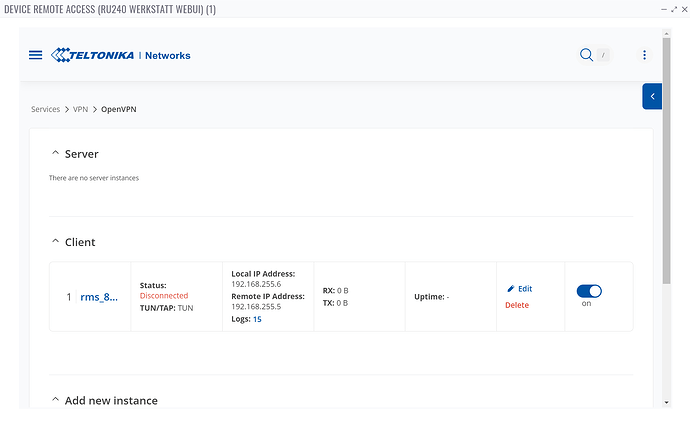

I am using a RUT240 device in our workshop, and trying to connect remotely via Open-VPN, using the “Teltonika RMS VPN Hub” (Teltonika_RMS_VPN_Setup_0.9.0.7-beta).
Now the VPN connection starts up ok, connecting the to remote LAN, and for some time I have access to all connnected devices (Simatic PLC, HMI, other), but every 30 seconds, sometimes after a few minutes, the VPN apapter “disappears” and restarts, interrupting all connections.
This happens using different Windows 10 and 11 computers, from different locations via different networks, in the same way.
Any idea what I could do ?

Thank you for reaching out and providing detailed information about the issue.

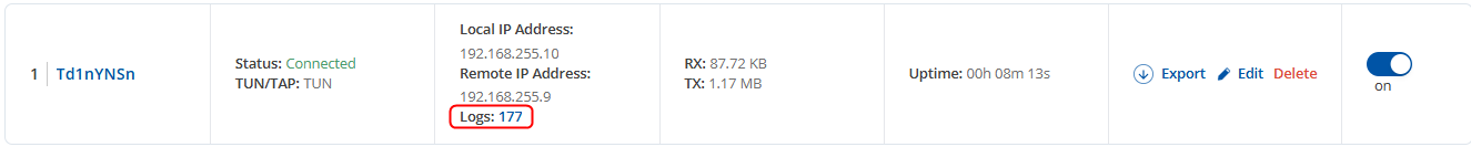

To better understand the situation, could you please provide the OpenVPN logs from the RUT240 client side? These logs can be accessed in the router’s web interface under Services → VPN → OpenVPN → Client’s Logs section.
Dear Martynas,
thanks for your message. Unfortunately I cannot see any “Client’s Logs” section at the OpenVPN section. The attached screenshot shows what I can see there:
And this is the version data of my RUT240:

Could it be, in my OpenVPN Client, where you can select TUN/TAP, TUN is selected, whereas the “VPN Ethernet Adapter” is named “TAP” ?
Best regards, Thomas.

Hello Thomas,
The virtual tunnel interface type should indeed be TUN, so everything seems correct on that end. I’ve tested a setup similar to what you described. Could you try (if you haven’t already) updating the RUT240 client’s configuration and certificates?
It’s normal for the RUT240 to take a bit of time to establish a connection.
Additionally, ensure that the routes to the RUT240-connected LAN devices are configured correctly in the RMS VPN Hub’s Routes section.
For viewing the OpenVPN client’s logs, you can click on the “Logs” text in the OpenVPN Client section of the web interface.
If you haven’t done so already, you may also try restarting the VPN Hub to see if it makes any difference.
If the issue persists, I’d like to investigate further. I’ve sent you a form to fill out. Please use “11758” as the ticket ID when completing it. Once submitted, we’ll contact you privately to proceed with further investigation and troubleshooting.

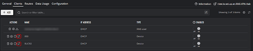

2.) Delete the VPN hub from RMS. Also delete the corresponding “OpenVPN client” from the device.
3.) Set up a new VPN hub, with client, routes. (So that it looked like before.)
