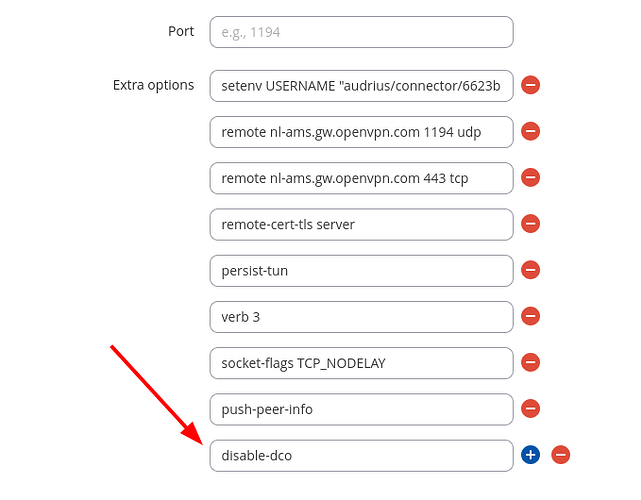

The issue was resolved by adding the disable-dco option directly to the client’s OpenVPN configuration file (.ovpn).
This can be done via the WebUI by editing the OpenVPN client configuration, following the example shown in the screenshots below:
