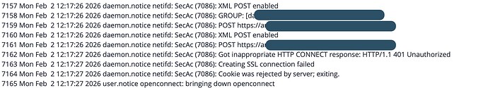

Hi Team. I’m trying out the OpenConnect package on a RUTX08 and this against a Cisco headend, so using AnyConnect as the profile. The connection fails and looks like it’s resolved in a later OpenConnect package - Got inappropriate HTTP CONNECT response: HTTP/1.1 401 Unauthorized - Cisco AnyConnect external authentication (SAML) when connecting to /CSCOSSLC/tunnel (#659) · Issues · OpenConnect VPN projects / OpenConnect · GitLab

Hi @Matas - basically error message is as described in the discussion link in the original post where the ‘fix’ was an updated OpenConnect package. The ‘Cookie was rejected by server’ error pointing to how OpenConnect presents itself as an AnyConnect client……the OpenConnect update providing an update to this mechanism.
