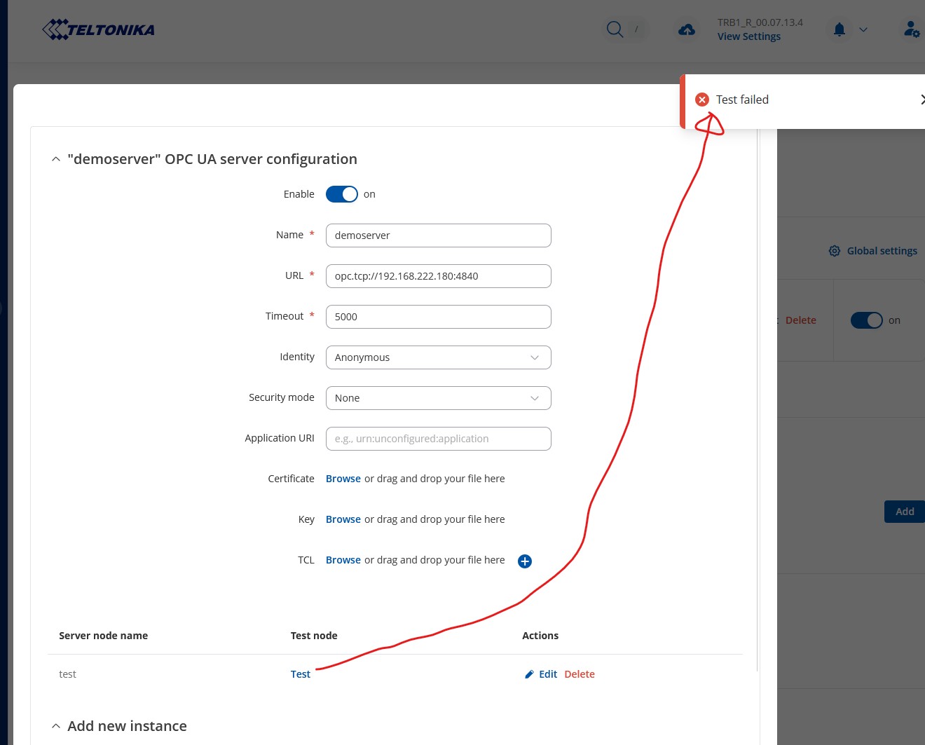

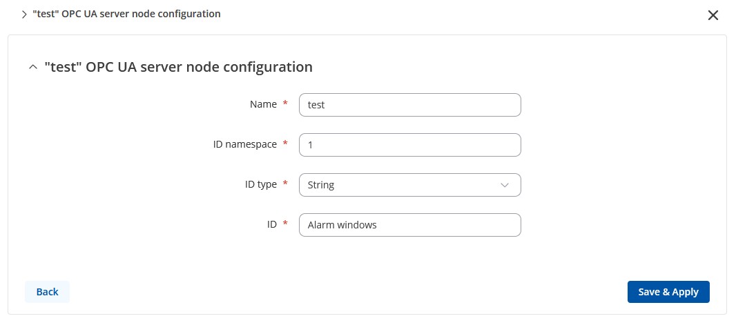

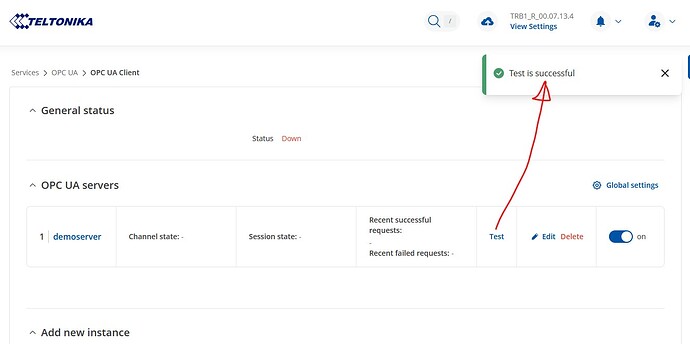

When using OPC-UA Client service at an TRB140 I am not aible to read a node at the server without error but when I am using Windows Software “Prosys OPC UA Client” I can read exactly the same node without any fault.
Could it be there is an bug when I have ID type “String” and the NodeId Identifier has spaces in the ID, for e.g. “Alarm window”?
Setting in nano /etc/config/opcua_client are the follow
