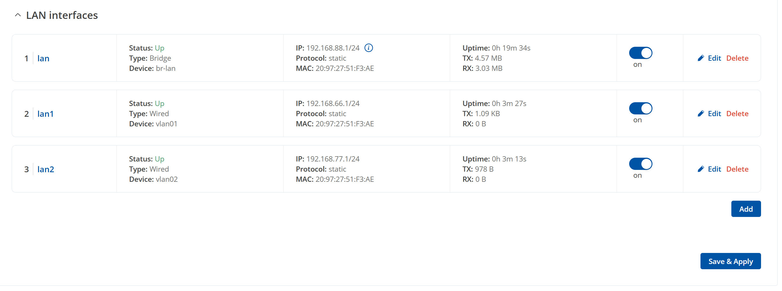

I what to connect an ODT140 (LAN1) to an TSW202, but i what to use two VLAN.
I have used 802.1Q and created two VLAN. But i can’t connect to the VLAN via ID on PC or TSW202 ?

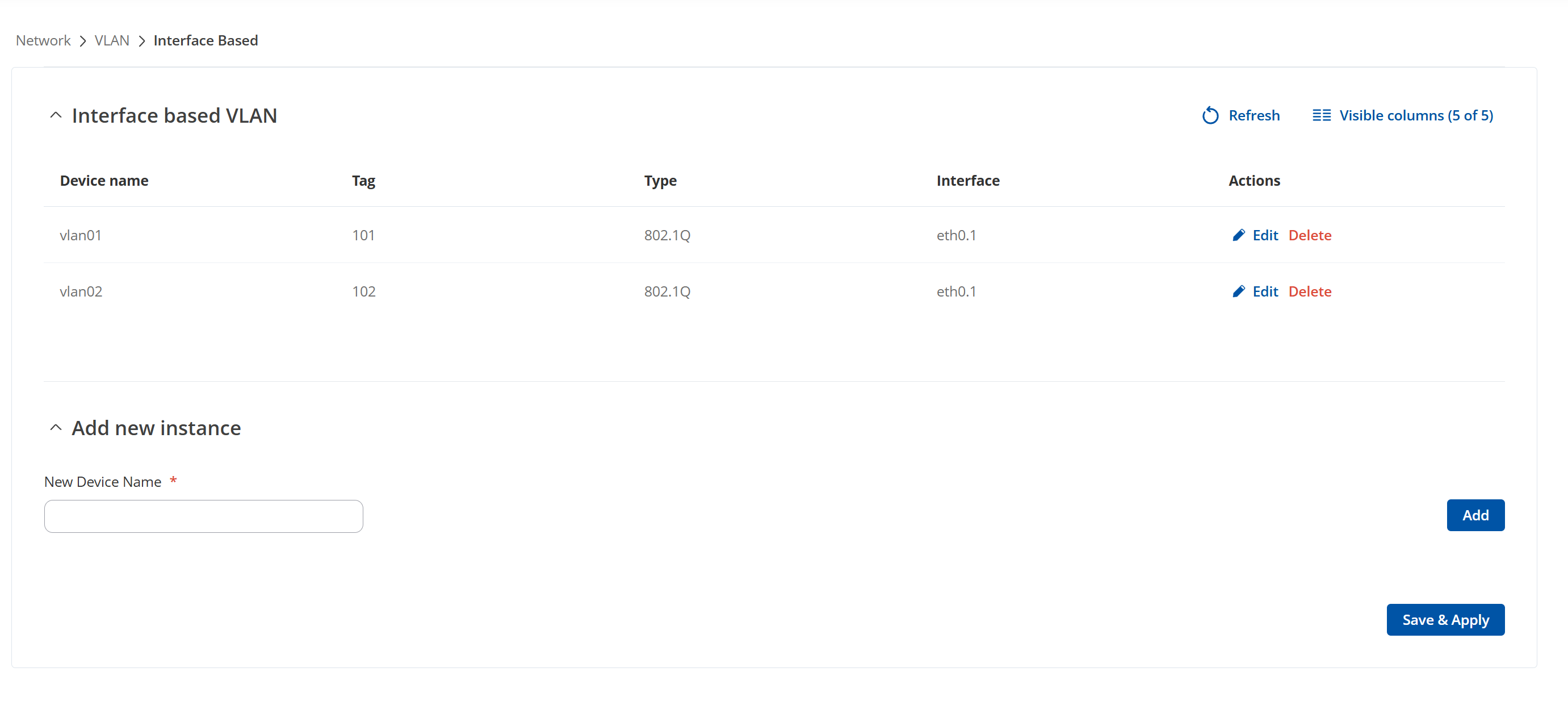

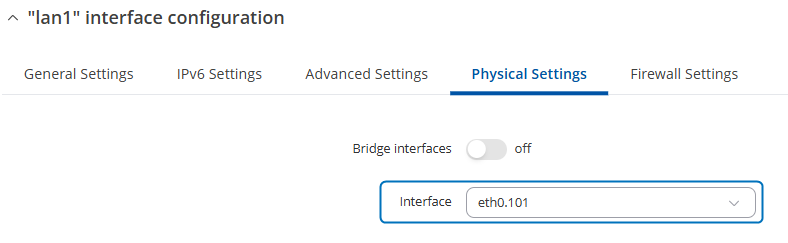

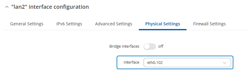

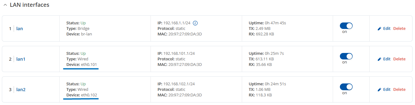

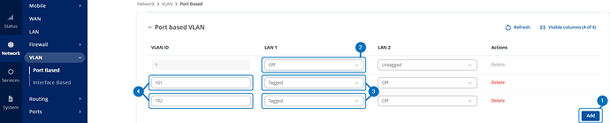

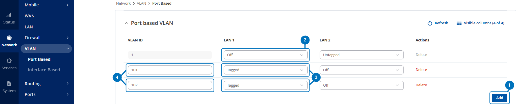

If this is the intended setup, with multiple tagged VLANs on a single port, it can be achieved by using tag-based VLAN configuration via Network → VLAN → Port Based settings. Here’s how the configuration might look:
VLAN settings page

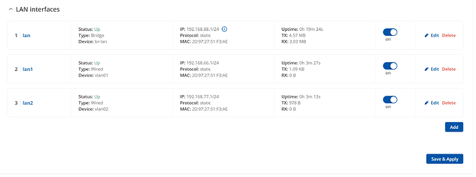

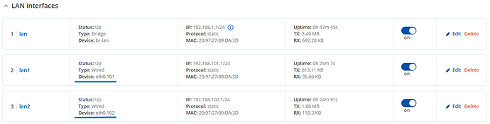

LAN settings page

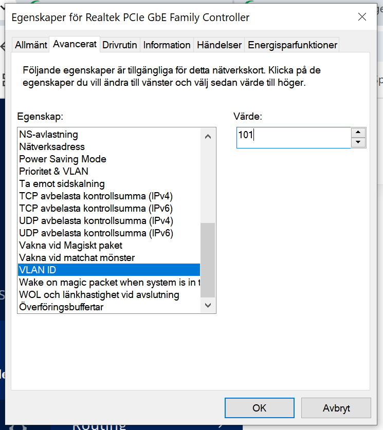

With this setup, you should be able to set a VLAN ID on your PC’s (or via the TSW202 switch port settings) and obtain an IP address from the corresponding VLAN’s DHCP pool.
