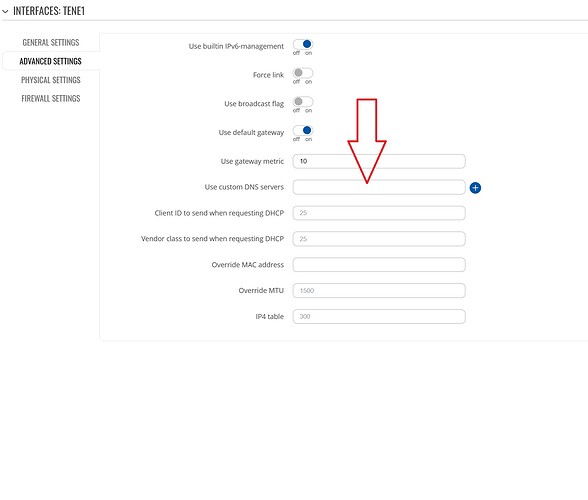

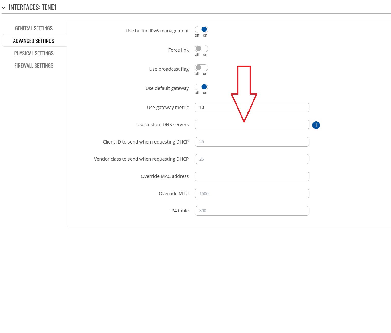

Solution:Please update manualy DNS on interface which you are using for internet and write NordVPN DNS IP as below:
103.86.96.100
103.86.99.100
It should work after this update.
