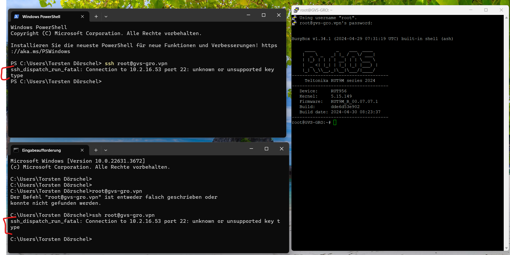

“ssh_dispatch_run_fatal: Connection to 10.2.16.53 port 22: unknown or unsupported key type”
This is on a RUT956 out-of-the-box, only mobile connection and OpenVPN tunnel set up.
Access via vpn.

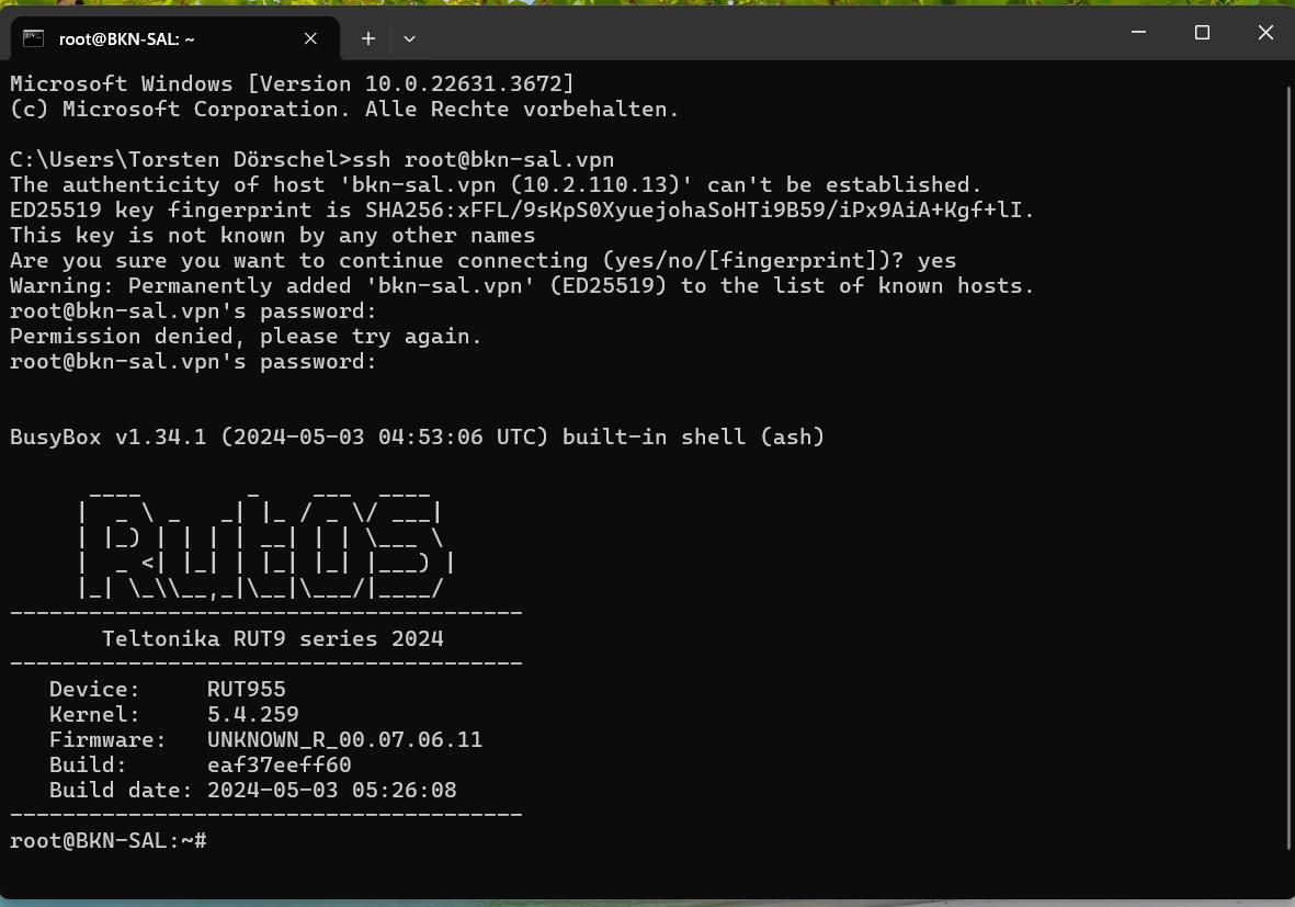

Same route (same vpn access, same setup) but different router and firmware (RUT955 with 7.6.11) success via command line

I could test on-site yesterday: SSH with Windows CMD works from LAN and WAN interface.
Only via VPN, it fails.

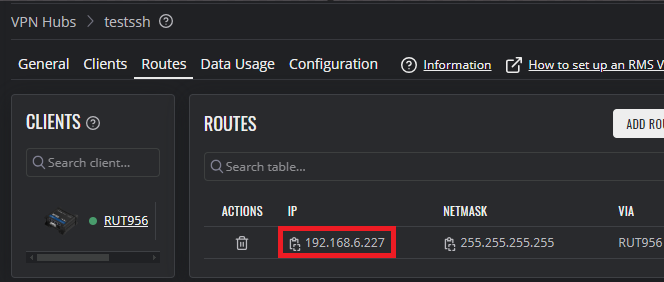

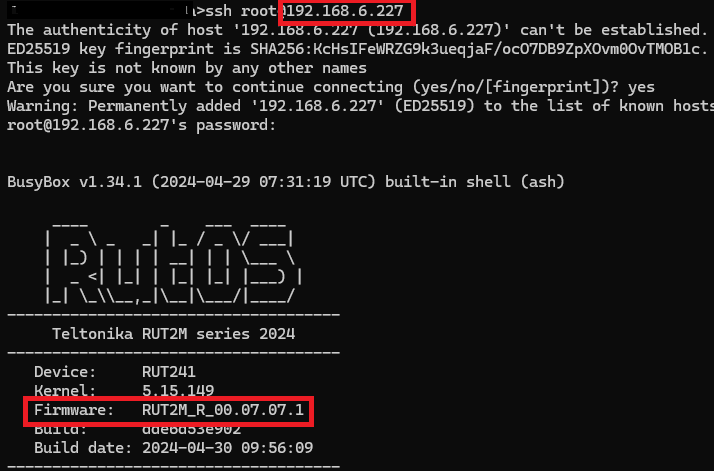

I created a VPN hub via RMS (OpenVPN) and successfully connected via SSH remotely (using the VPN IP) to both RUT956 and RUT241 devices, both running firmware version 07.07.1.
Unfortunately, I wasn’t able to replicate the issue you’re experiencing.
