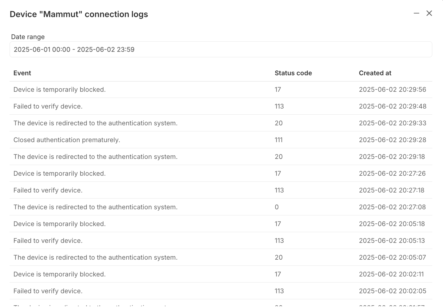

Tried everything, but it still does not work. Paid for 5 years and there is still time. But can not reactivate the device.
Allways get device is temporarily blocked.

Do you have physical access to the device?
Can you advise what error do you get in cloud solutions in WEBUI?
Can you also confirm you have went through every step in the guide provided? Especially sending commands via CLI to open RMS ports, and the rest?
Can you also advise whether you have tried to remove, and add the device, while checking what error you get in cloud solutions?
For testing purposes, can you also check whether you are able to connect to RMS system after a firmware downgrade for 7.13.4 or below.
Arturas
I got it back to the list. Do not know why. But I removed it and connected it again and it worked.
