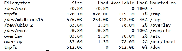

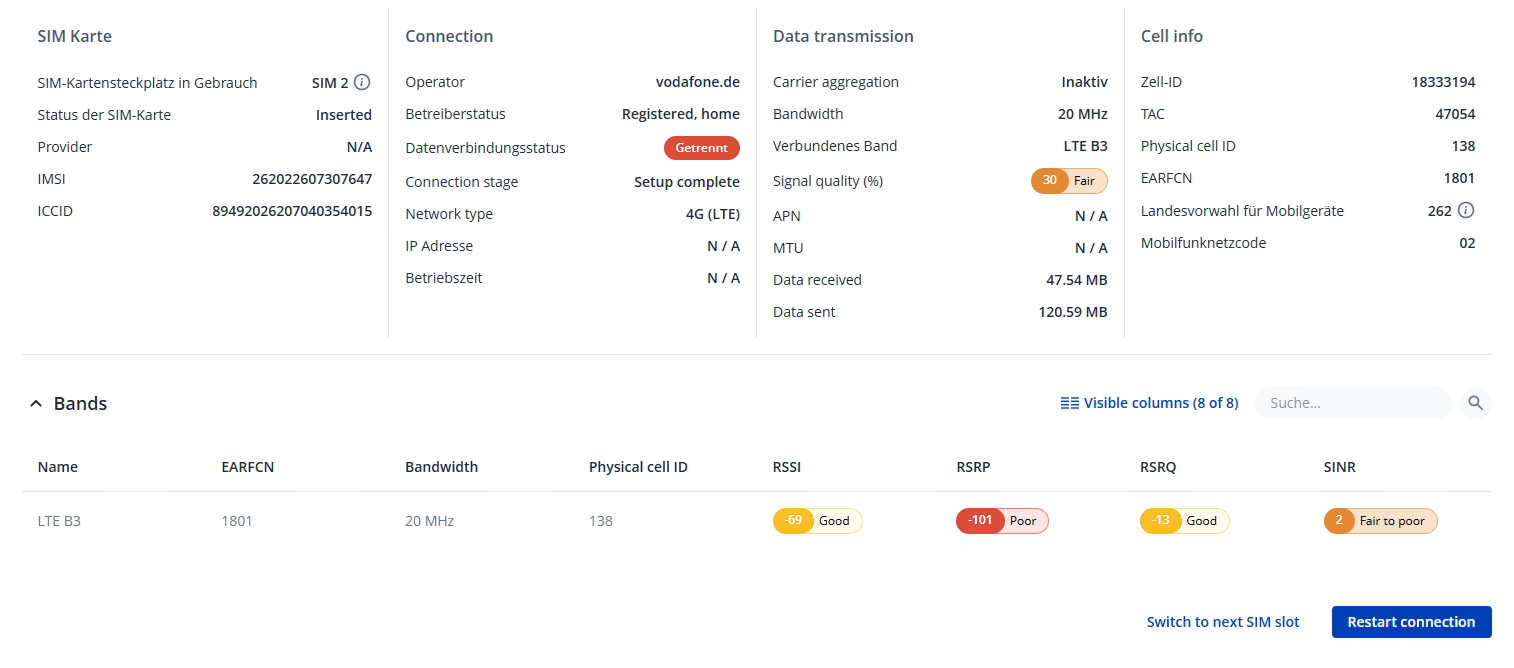

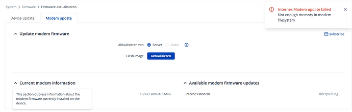

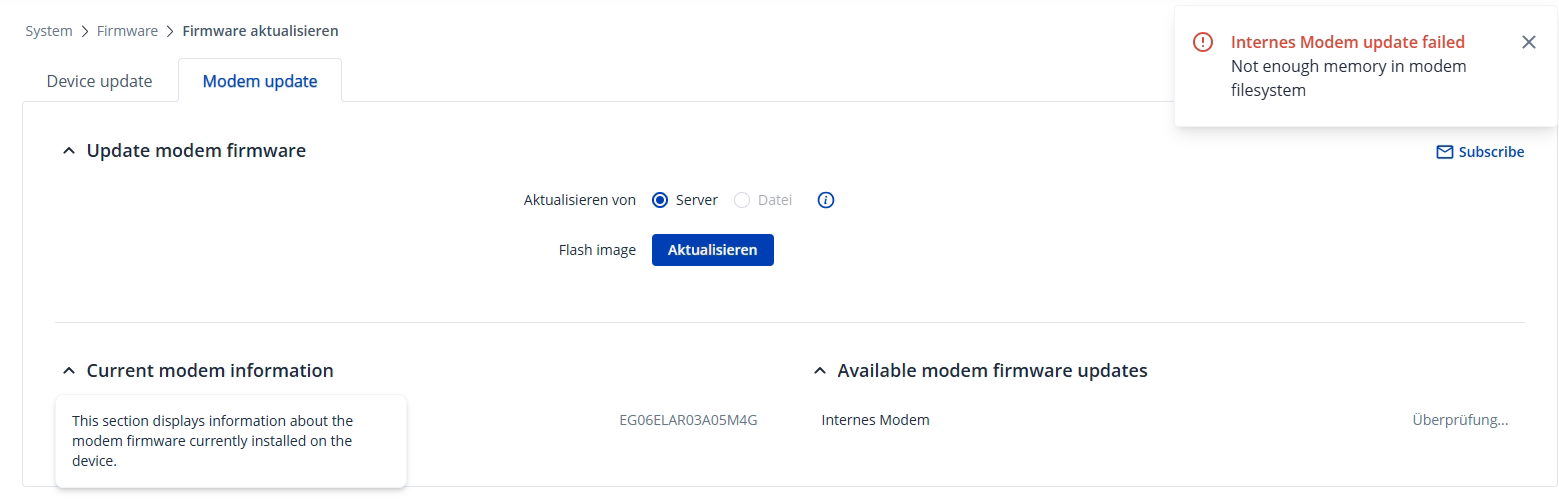

my RUTX11 has recently stopped establishing a mobile connection; the SIM is detected and—according to the status indicator—correctly registered. Additionally, the new modem firmware update fails with an “Insufficient memory” error.
I tested the SIM in another RUTX11, and it works fine.

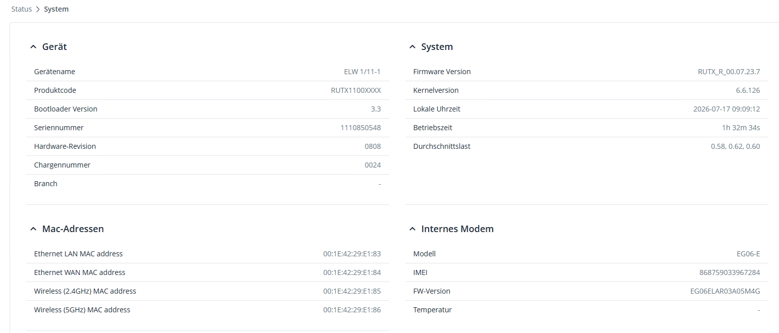

Product code: RUTX1100XXXX
Router FW: RUTX_R_00.07.23.7
Modem FW: EG06ELAR03A05M4G
I have attached a few screenshots.
