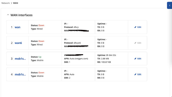

Could you confirm that the correct APN is selected? It might be necessary to specify it manually by navigating to Network → WAN → mob1s1a1 → Edit in the router’s WebUI.

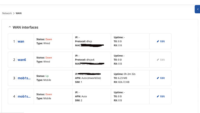

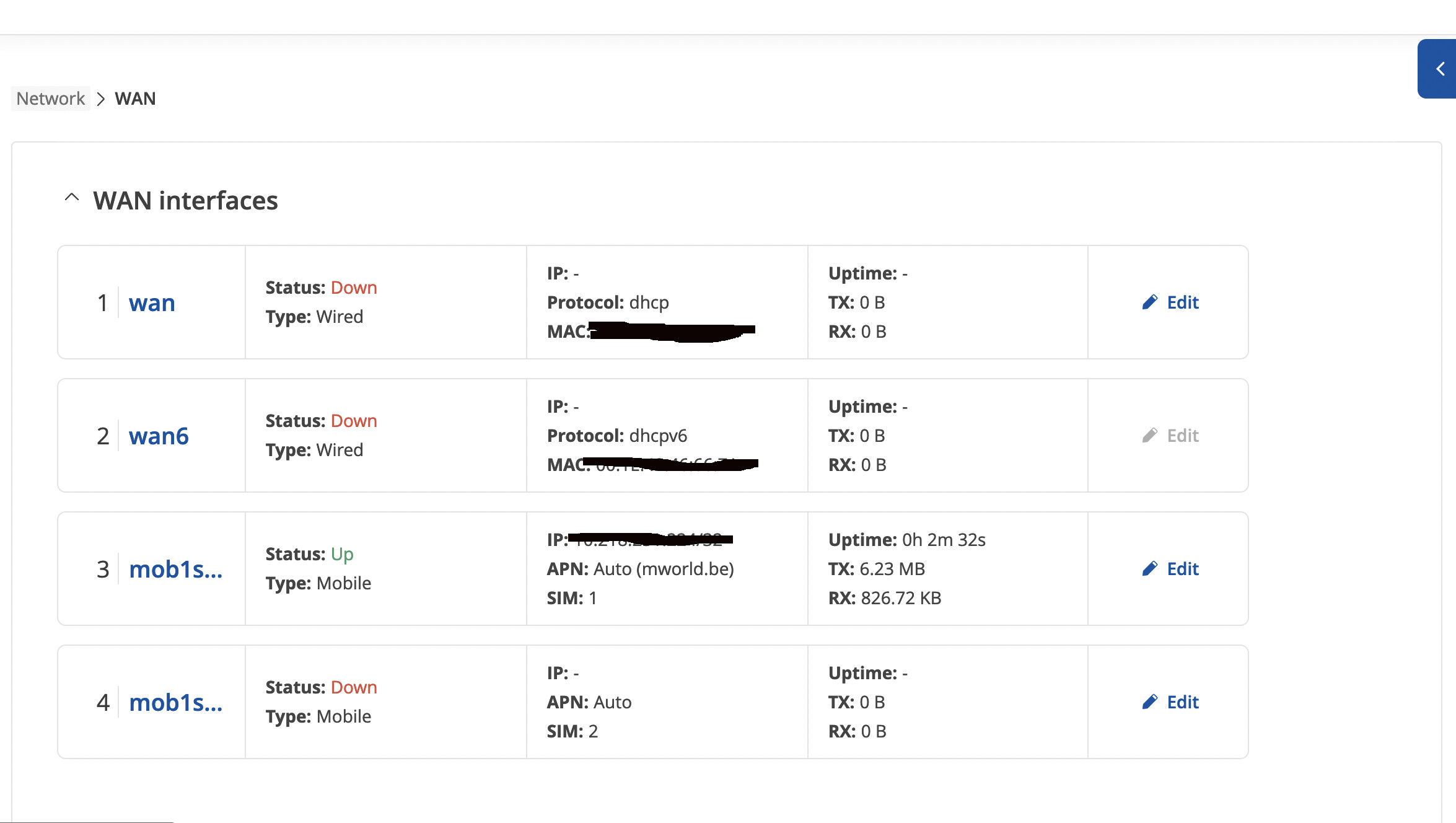

hey,
still i have a lot of problems.
below there is an image of my wan interfaces, but i don’t see a way to change the order of my wan connections
To change the metrics (priority) of your WAN interfaces, you need to switch to Advanced mode
Could you also provide more details on the specific problems you are still experiencing?

hey,
i thought the problem was solved because my wan is active but still, no internet acces, my signal strength is excellent, and i’m connected to right ssid everything is active, still no internet acces…
how can i change the order of the wan interfaces?
i’ve found how to change to advanced mode, i changed to order and i’ve put the active interface first, still no internet acces…
To assist you further:
  1. Could you please provide a screenshot of the Network → Wireless page? This will help verify the wireless connection settings and ensure the AP as the client is correctly configured.
  2. If your mobile interface (mob1s1a1) is your only internet source, it wouldn’t make any difference by setting it as the highest priority / metric.
  3. Can you attempt to ping an external IP (e.g., 8.8.8.8) through:
  • CLI: Run the command ping 8.8.8.8.
  • Or, use the Diagnostics tool in System → Maintenance → Troubleshoot.
Please let us know the results for further guidance.
