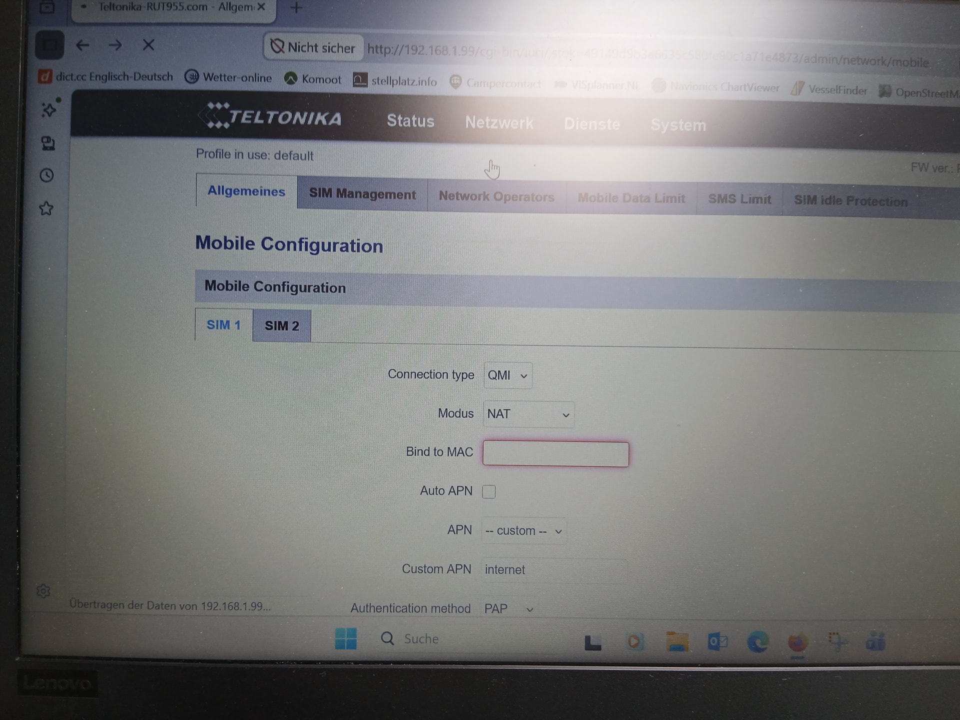

After filling in the data fields with apn and so on and saving, then tere is short a message with a red empty field called “bind to mac”. I think, that is the issue, but I have no solution.

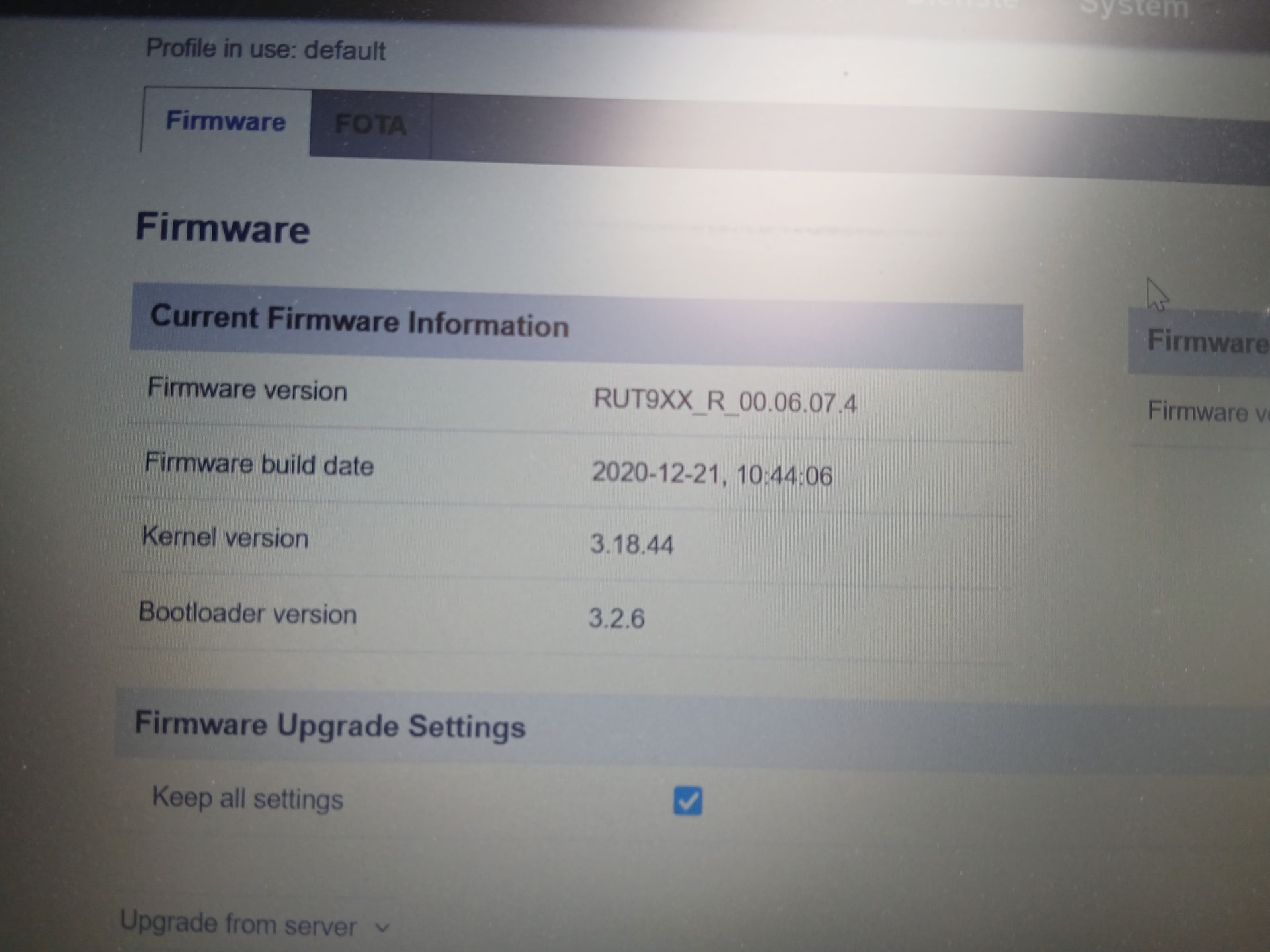

To assist with further investigation, could you please provide the following information:
  • The firmware version currently installed on the router
  • A screenshot of the mob1s1a1 interface settings
  • A screenshot of the error message you are experiencing
This information will help us continue the investigation.
I look forward to your reply.

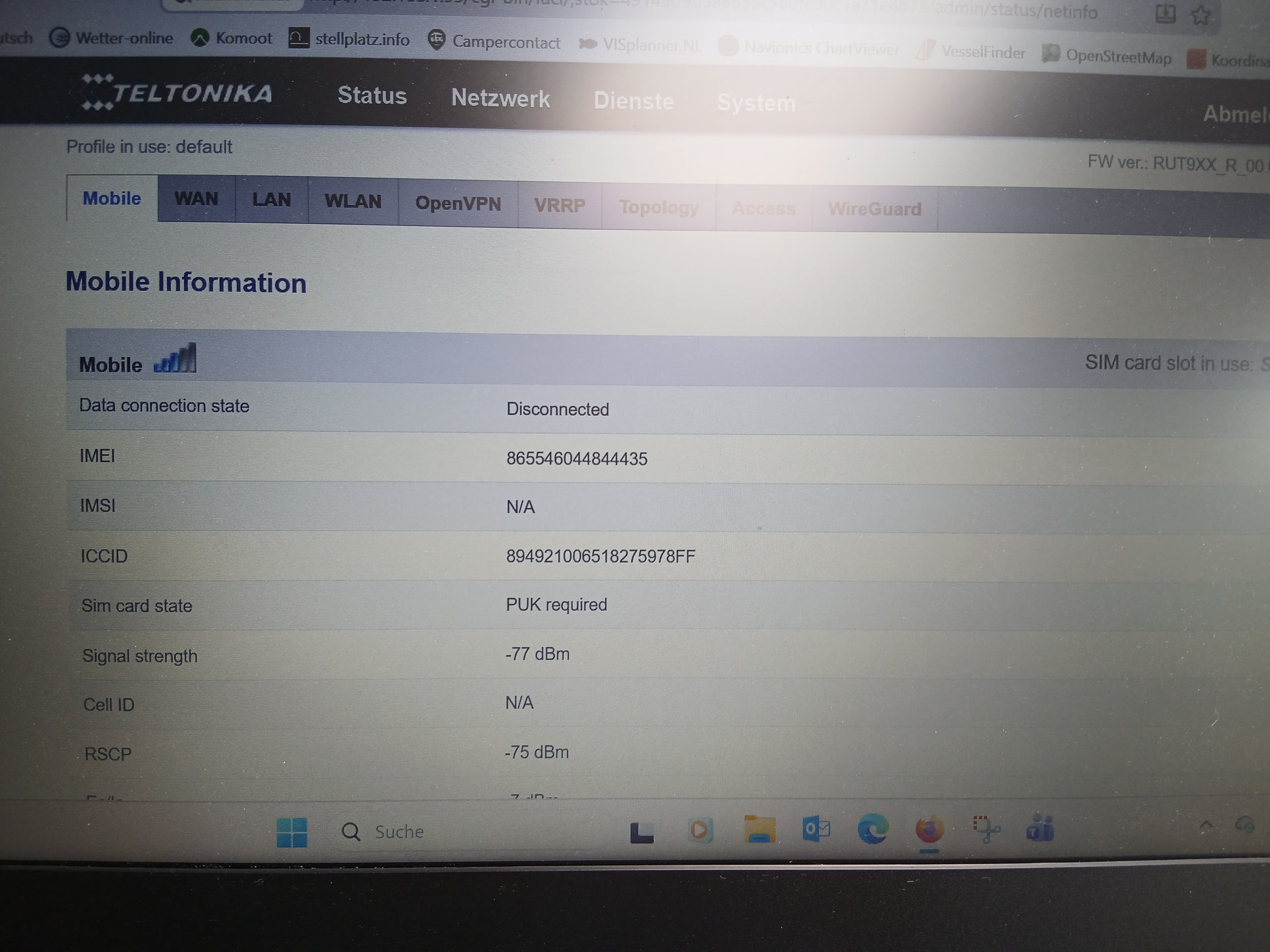

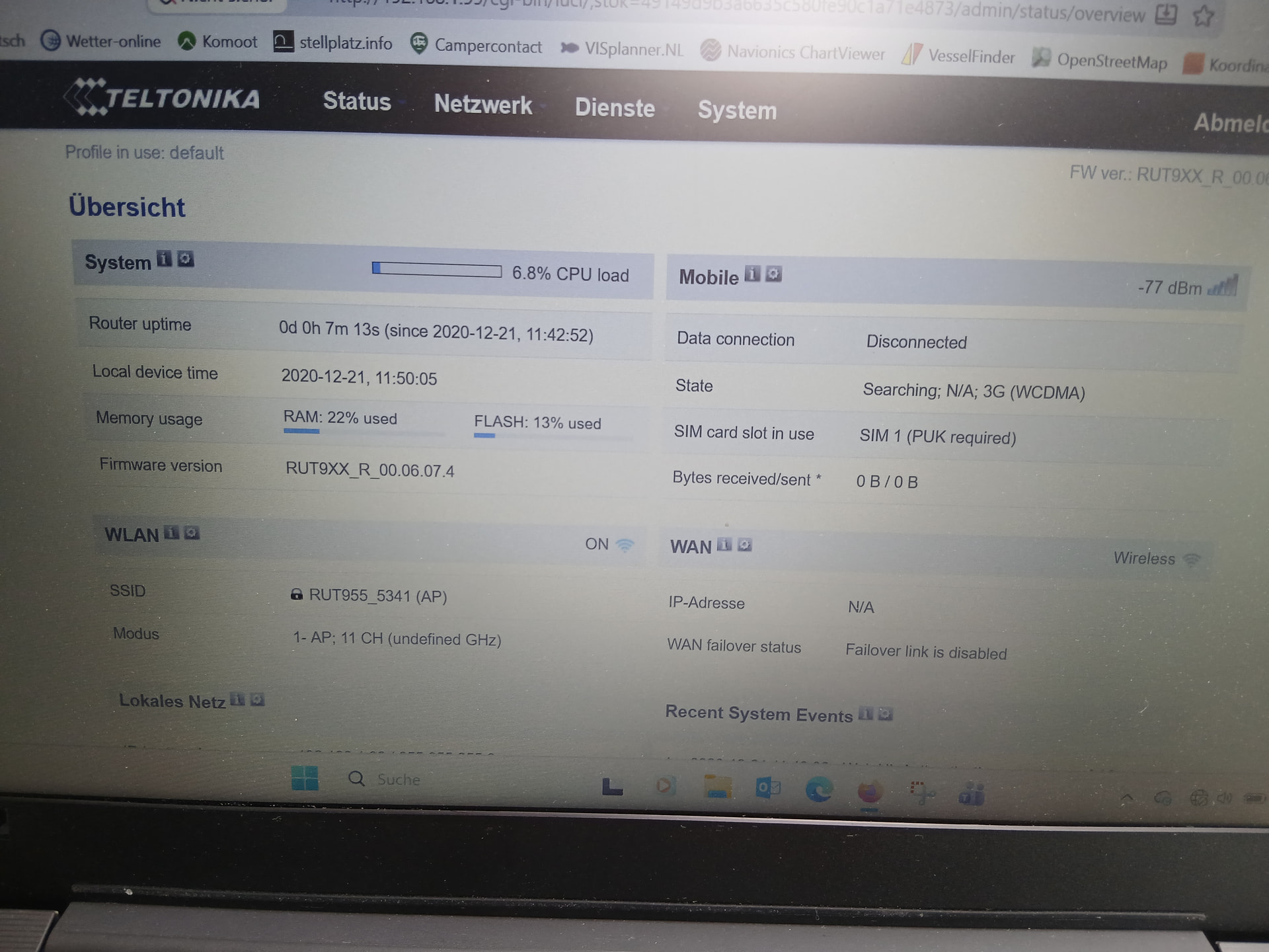

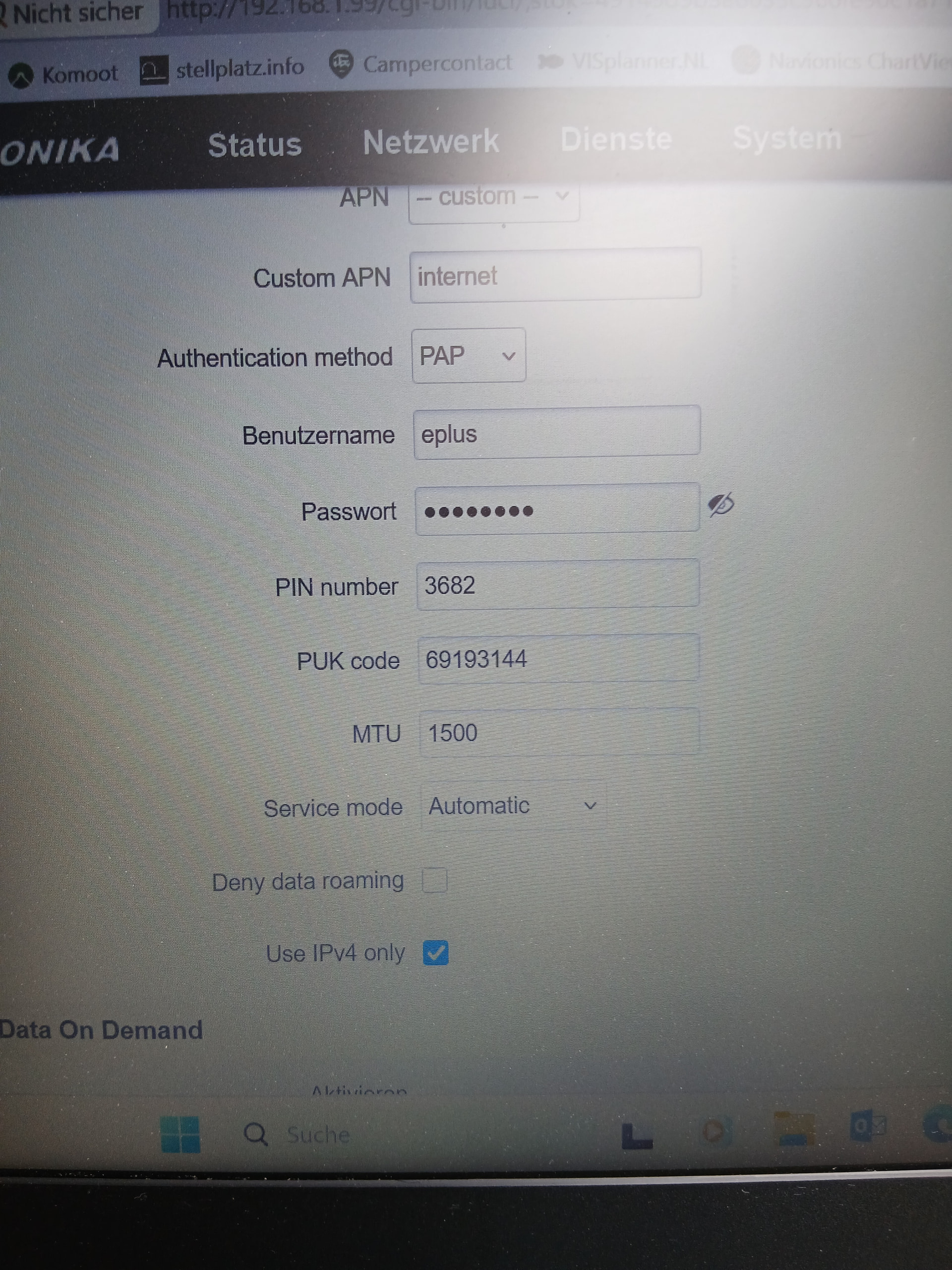

Here some fotos from the desctop of my notebook, which is connected by lan.

Based on the screenshots you shared, SIM1 appears to be requesting a PUK code. I can see that a PUK code has already been entered, so the error may indicate that the code is incorrect.
Could you please try the following?
  • Test the router with a different SIM card to determine whether the issue is SIM-related.
  • Contact your mobile network provider to verify that the PUK code you are using is correct.
Please let me know the outcome, and I’ll be happy to assist you further.
