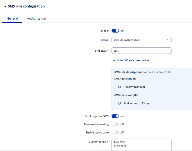

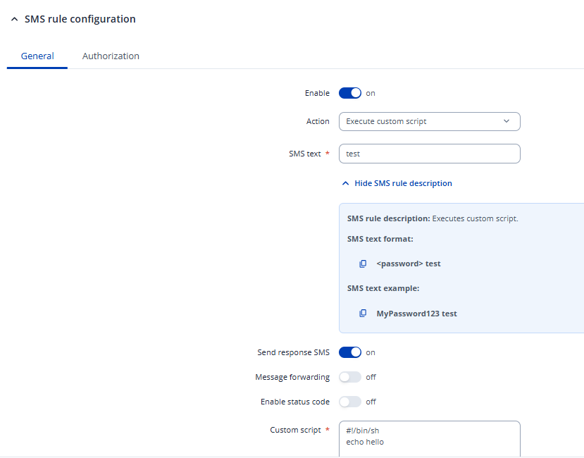

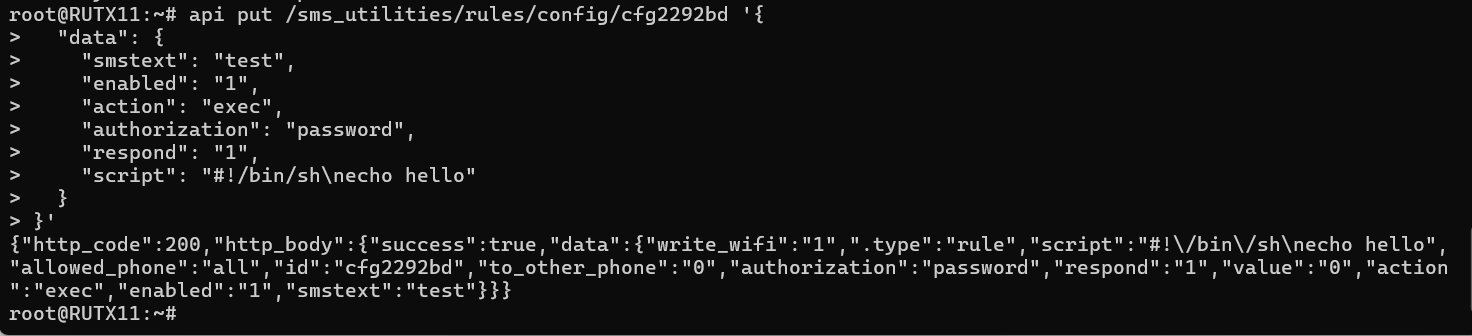

I don’t have a custom script to test this with, but I tried putting in the rule via a simple api call through the SSH, and seems like I was successful:
I found the issue.
The script must start with #!/bin/sh\n
In my script I used “#!/bin/sh \n“ which give an error.
