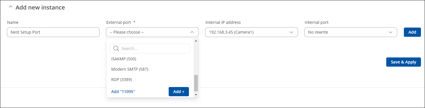

First we need to setup a static lease IP for the camera. This is so the Port Forward rule, that we set up later, will always be able to find ‘that’ camera at ‘that’ IP. In the WebUI at NETWORK > DHCP, click the ‘add’ and enter in your camera’s unique MAC address, a unique IP address of your choosing (on the lan) and give your camera a name. Don’t forget to click ‘Save & Apply’ In the example below, you can see I’ve given the MAC address of the camera an IP of 192.168.3.45 and called it ‘Camera1’. Note: I’d recommend doing this anyway.
Next we’re going to create and set up the Port Forward rule. In the WebUI at NETWORK > FIREWALL > PORT FORWARDS in the ‘Add a new instance’ boxes - we give the instance a name, the port we want to open, the destination IP of the camera that we set up above and lastly, by telling it to use the same port number on the camera (No rewrite). Here I am assuming that the camera also uses port 11095, but if this doesn’t work, try changing this internal port to HTTP (80) or HTTPS (443).
When you click on ‘Save & Apply’, you’ll get a pop-up … just enable it, check it follows the same pattern below, and ‘Save and Apply’.
And there you have it … your port forward is now created.
Use this same port forward to set up each camera in turn, just changing the internal IP address to be that of the camera being set up, after you have created a static lease for it.

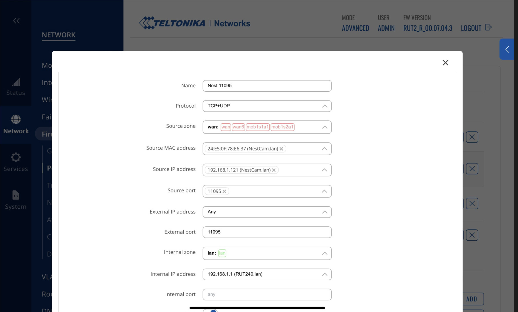

The problem with Port Forwaring is that your documentation does not match latest version of your firmware. Terminology on device had changed, but terminology in documetation still old.
I am using Advanced mode.
I am using following version of firmware: RUT2_R_00.07.04.3 - checking for firmware update saying this is the latest.
however ON THE DEVICE there are NO “Destination Zone, Destination Address, Destination Port” when creating port forwarding. There are only SOURCE and INTERNAL and I dont understand meaning of these words. What is “Source” and what mean “Internal”? And how documentation terminology can be translated to device terminology?
And to the Mike - I really appreciate your attempt to help, but you are using some third set of terminology, as terms you are using are not present neither on site documentation nor on my RUT240 web ui.
I am at the point, when I have installed UPnP and set it enabled. - camera does not installs.
I have port forwarding for 4 ports, mentioned by google, yet, I have no clue if port forwarding is correct, as “internal” can be camera and “source” can be camera, and even “Destination” can be camera - depends on terminology and point of view.
Please advise on how this form should be filled (each field, please)

Hi Egor,
Apologies, my examples were taken from a RUTX50 on firmware 07.06.6, so now I see the dialogue is different to your firmware version.
So, to populate your example …
Name = Nest 11095
Protocol = TCP + UDP (don’t know if Nest relies on ICMP but could add it in aswell, if these 2 don’t work)
Source = wan
Source MAC address = Any
Source IP address = Any
Source Port = Any
External IP Address = Any
External Port = 11095
Internal zone = lan
Internal IP address = [insert the camera IP that you set up as a static IP in DHCP]
Internal port = 11095 (I assume your camera requires the same port number)
Send screen shot if struggling to complete the above.
As an explanation of the boxes, the following can be considered ‘advanced’ options and the first 3 are used to lock down the port to match traffic only from a particular ‘device’ on the wan (internet). As we don’t know these details of the Nest infrastructure, we will accept input from anything that ‘talks’ to us on port 11095 - hence the ‘Any’ setting …
Source Port = Any
I’m assuming you have the ‘Any’ option for all of the above.
The key ones for you are …
Protocol = TCP + UDP (The ‘usual suspects’ for protocols over the internet)
Source = wan (we are ‘listening’ for traffic coming from the internet)
External Port = 11095 (we are only interested in external internet traffic, with the above protocols, hitting this port)
Internal zone = lan (we are going to forward this traffic to the lan)
Internal IP address = [insert camera IP] (and this is the camera on the lan that we want to forward this traffic to)
Internal port = 11095 (and the camera is ‘listening’ for this forwarded traffic on its own port of 11095)
Good luck
