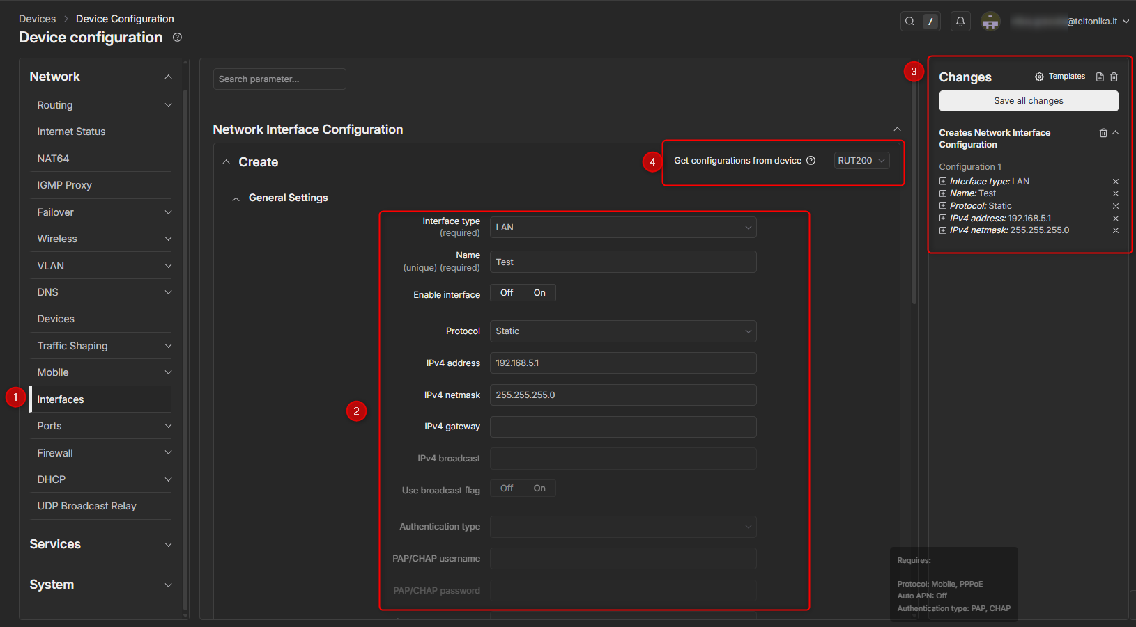

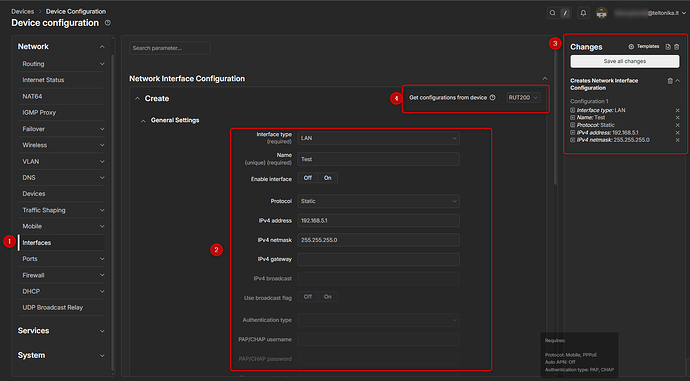

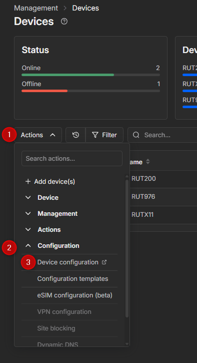

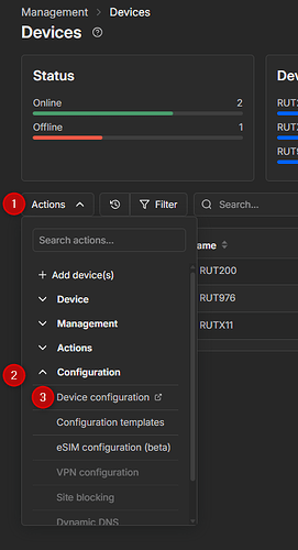

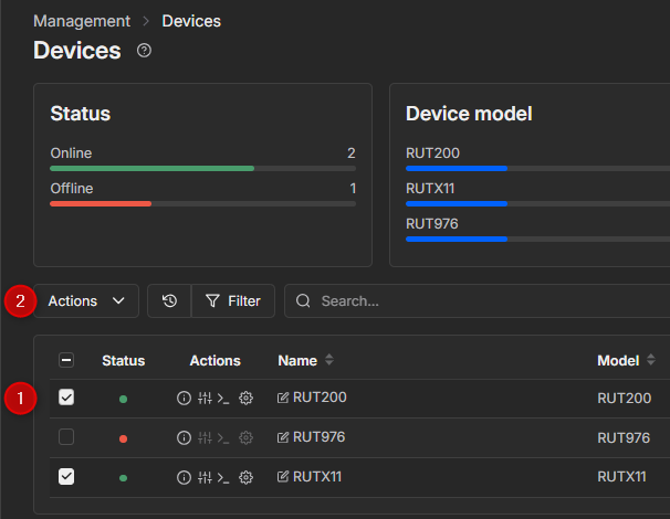

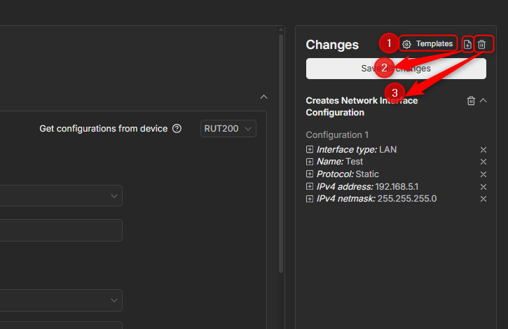

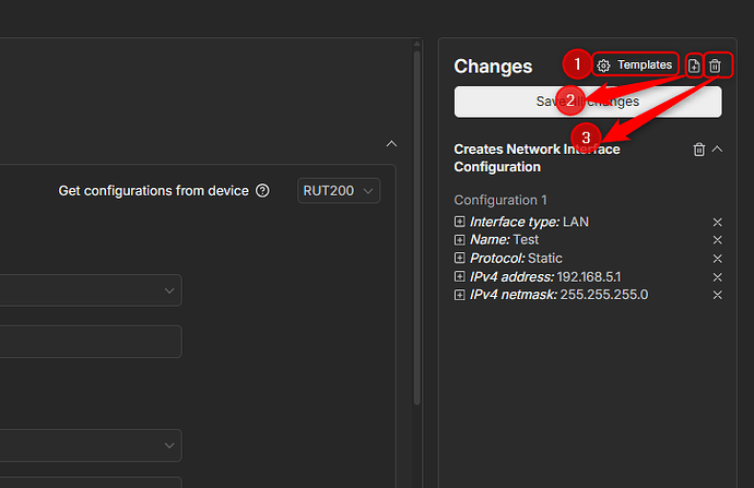

It is possible to make a template to update settings of the multiple devices at once. Please make sure that devices are online in RMS. Once they are, you can select multiple devices.
Then navigate to Actions → Configuration → Device configuration
Then selecet Network → Interfaces in this menu, you will be able to Create / Update / Delete current configuration. For this example I am trying to create a new LAN interface.
  1. Select Network → Interfaces
  2. In this are you can configure interface’s settings.
  3. You will be able to see all of the changes that were made. If you want to edit any of the present changes, you can simply just click on a setting in that area, and you will taken to that field.
  4. This will allow you to choose a device on which configuration will be applied.

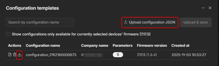

  1. By pressing on templates you can choose between the templates that you already saved and download export it as json file or upload a json format template.
  1. Allows you to save a template that you made and it will be available to download once pressed on “Templates button”
  2. Clears all of the changes.
For more information, you can refer to this wiki article:
