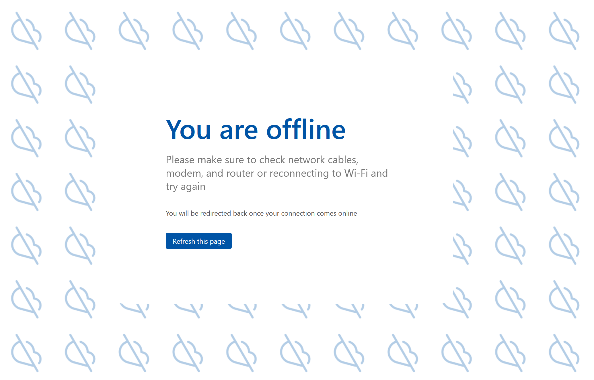

Anyway, after that “procedure” I cant access the RMS site. I can access anything else I try online (like this site, and all other Teltonika sites), so it’s a bit peculiar that it’s just RMS that is such a hassle. It should be noted that it is not only the RMS service that is unreachable (which I suppose uses it’s own port), but the https/web GUI is unreachable as well.

  5. Does the router have an internet connection? If yes, when it is connected to your PC, can you access websites like Google, YouTube, etc.? If so, is RMS the only site you cannot reach, which shows you are offline?

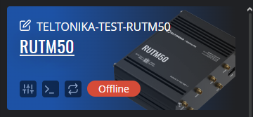

I’m currently experiencing similar issue. Router has network but shows Offline in Teltonika. What can I do to keep connectivity to the RMS?
Hello @tech,
Could you please check if your device has active credits for RMS? You can find more details here: https://wiki.teltonika-networks.com/view/RMS_Device_menu.
