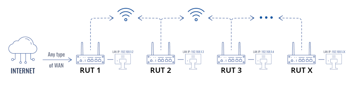

I’m trying to distribute a wi-fi network along a portion of a railway. My goal is to use only a single SIM to gain internet access, then repeat the wi-fi signal.

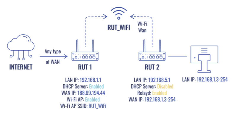

From here I’ve seen the following image
which is similar to my needs, but still not enough.
My goal is to reach something like this:
Is there a way to achieve this?

So, I start to set up two RUT200 in mesh mode: one gateway with a mobile SIM, and one node without the SIM and the DHCP server. Both are on the same WiFi channel.
It seems simple but it doesn’t work!
Unfortunately, the examples got from here https://wiki.teltonika-networks.com/view/Wireless_Mesh_configuration_example is not working for me
