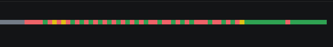

Here is my uptime after making the change - you can see just the one drop which is my auto reboot at midnight.
@mickwall,
  1. Your router loses connection because the modem attempts to renew its IP lease (pseudo lease) but fails to obtain a valid one from the network. This causes the router to think it’s still connected when it’s actually not. By setting DHCP to 0, the router does not attempt to renew the IP lease, preventing this issue.
  2. If you update the firmware with the “Keep settings” option selected, this change will not be lost.
Additionally, our developers are aware of this issue and should address it in a future firmwares. However, I don’t have an exact timeline for when this fix will be released.
