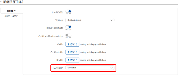

First, I’m glad that you seem to have resolved the issue.
As for changing the TLS version, you can find it under the Broker settings:
Thanks!
I’m just trying to use the built in MQTT client from “Data to Server”, didn’t have the MQTT package installed. I guess I can’t change it from there only?
So I need a MQTT broker in between in some way? I have to look at this.
