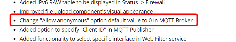

In v7.5 of RutOS, by default, MQTT broker does not allow anonymous connections. This is outlined in the 7.5 changelog:
Thus if you are not using credentials to connect to your MQTT broker, this option needs to be enabled in order to access the broker. This can be changed in the advanced MQTT broker settings.
This change was done due to security reasons, to avoid exposing the broker to the public internet without explicit user understanding.
Hope this helps!

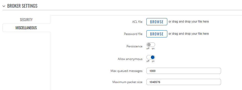

Indeed, anonymous connections are allowed:
