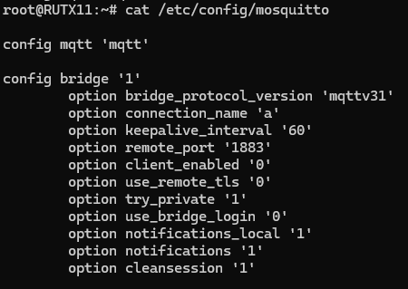

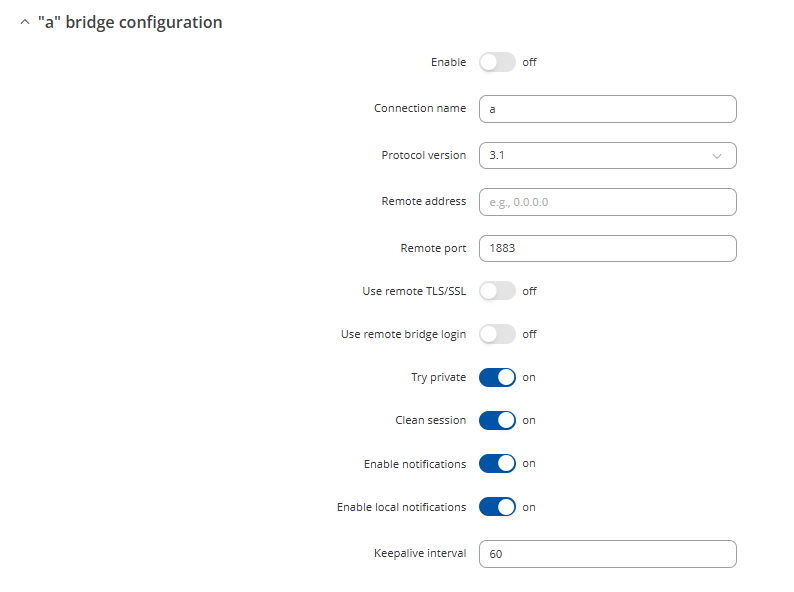

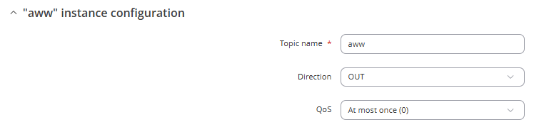

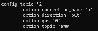

For the main MQTT configuration, the ones you’ve listed are the ones that are available. Anything extra looks to belong to the bridge & topic configurations as seen in the WebUI:
We don’t exactly have a list of ALL of the available options, but generally speaking, anything that you see in the WebUI will also appear in the config file.
