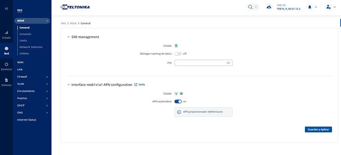

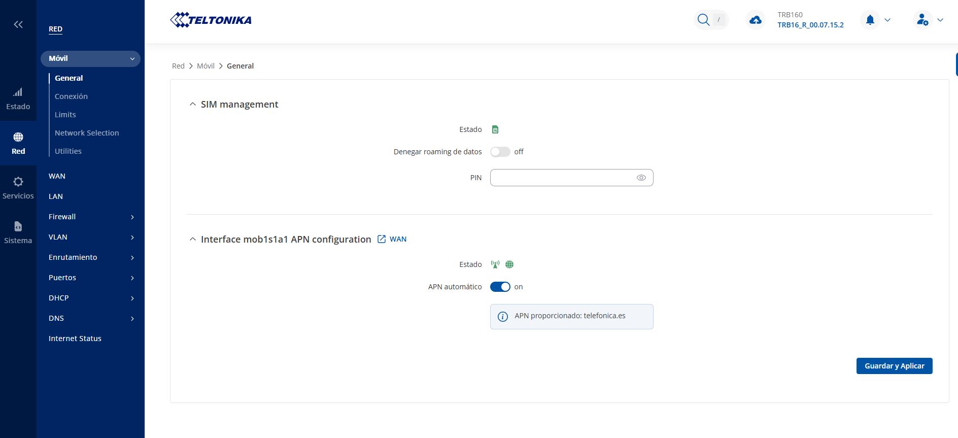

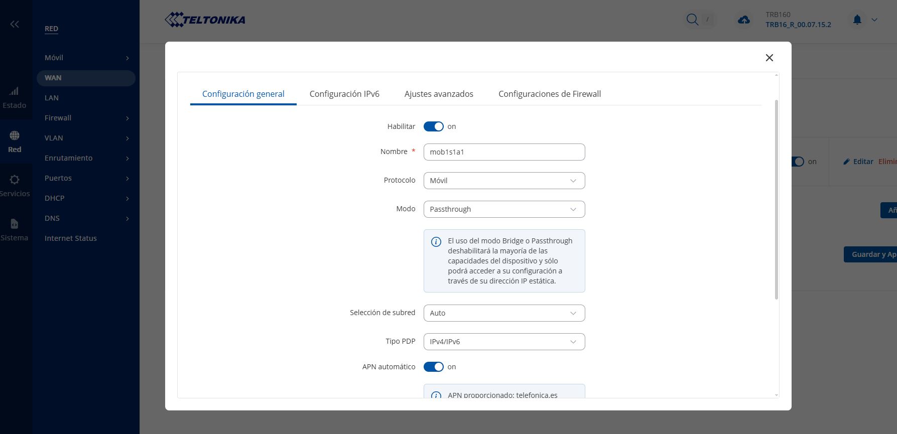

Buenas tardes Artuas.
Como puedo llegar hasta APN Bridge Passthrough?
Saludos Juan.

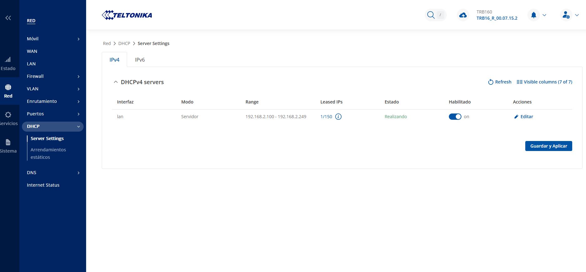

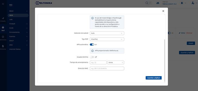

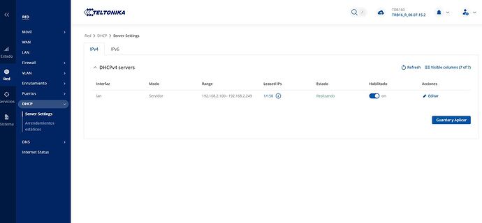

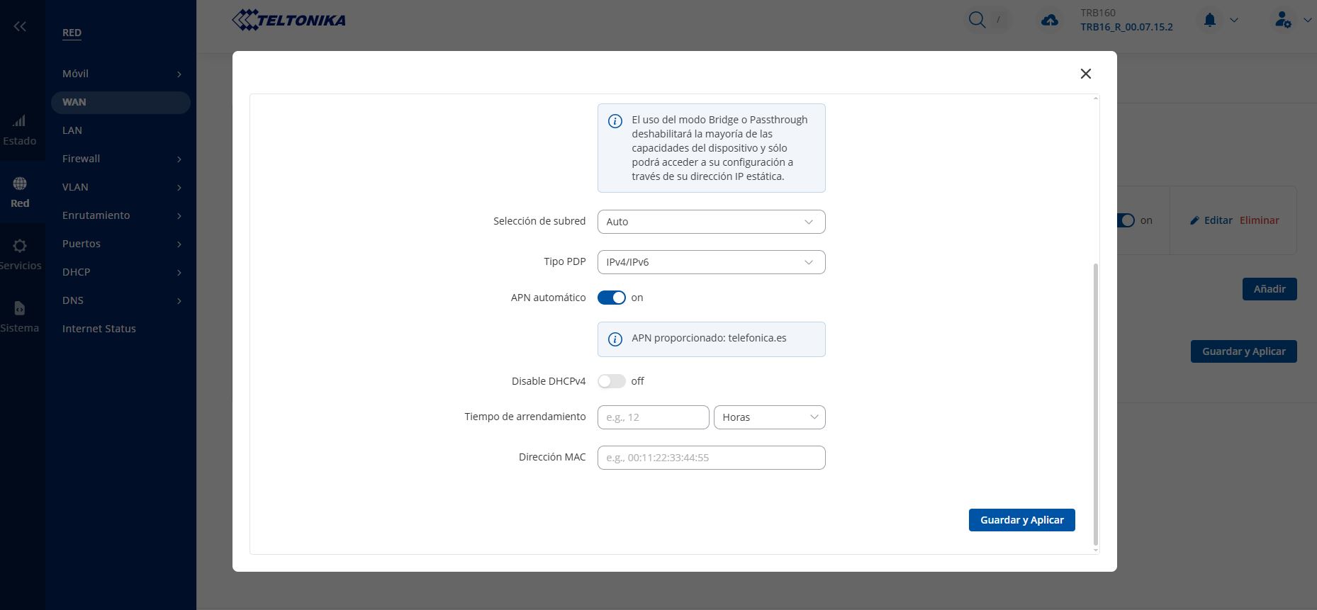

Buenas tardes .
He realizado esta acción, es la correcta?
Saludos Juan.
Yes, that is correct.
In Passthrough mode, the TRB160 disables its DHCP server by default, so your downstream device must be set to obtain an IP address automatically.
