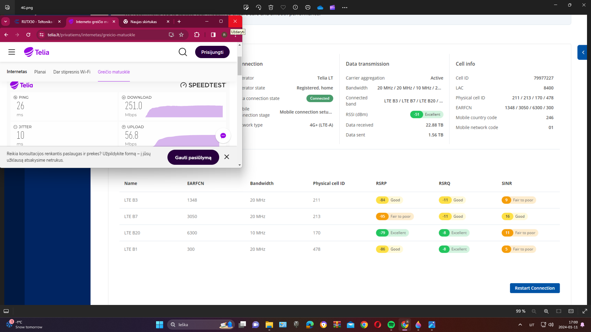

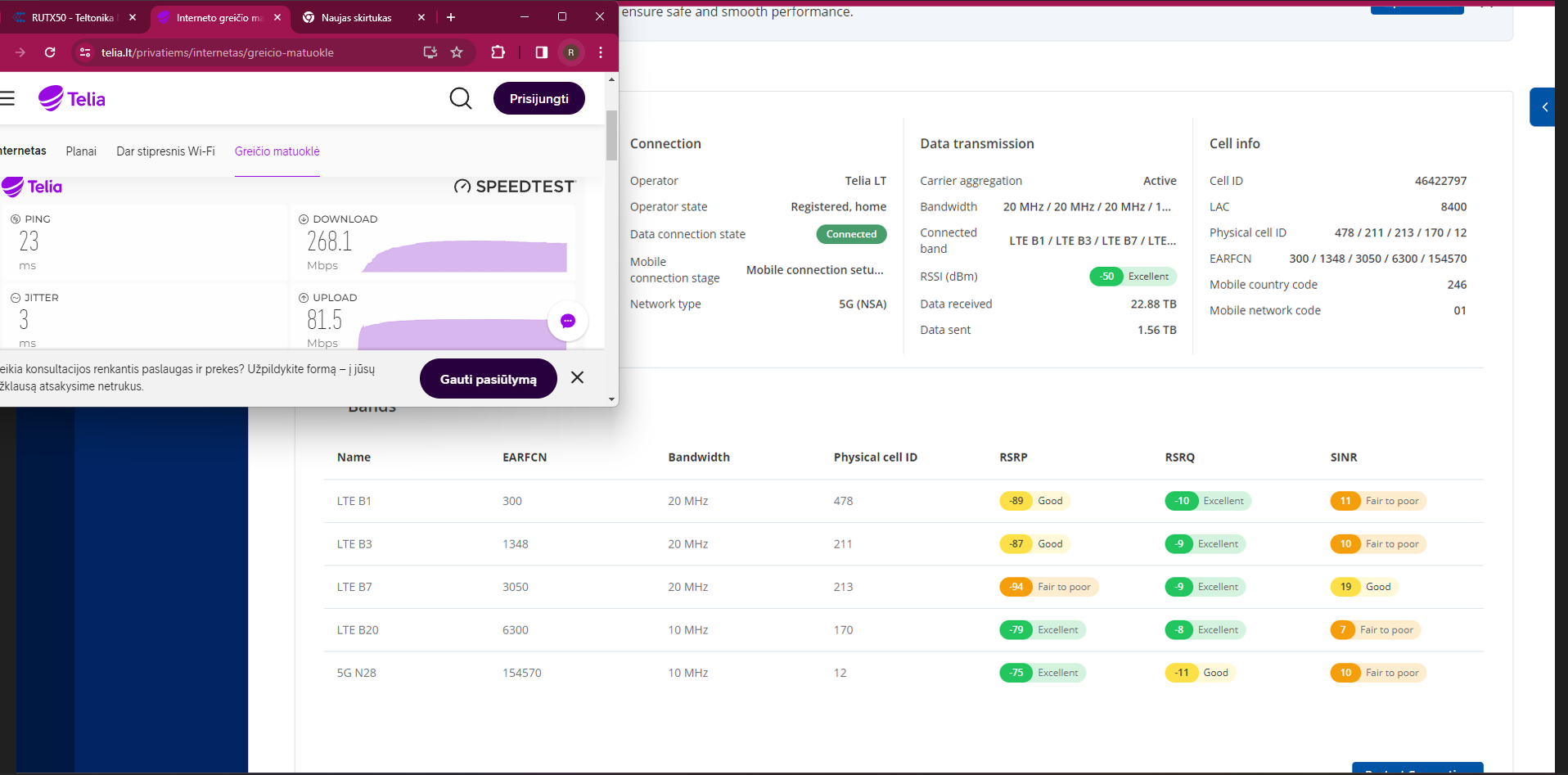

I finally got a chance to try Telia 5G and I was very surprised because the internet speed did not change at all after adding the N28 wave to the 4G aggregated waves. And when trying to connect only the 5G N28 modem RUTX50 did not connect to the network. What’s the problem here? So far, I have used this modem only in the 4G network and I was quite satisfied with its performance, and when a new opportunity appeared (TELIA started providing 5G services in my area), I decided to test the advantages of 5G, but unfortunately 5G does not work properly. During the entire time that I have been using the RUTX50 modem, the software version has been updated many times, but in the last version I noticed that there is no option to select only the 5G network. There is an option to automatically select only 5G; 4G; 3G and manually select waves. After manually selecting 5G all available waves and 4G wave which is not covered, the network is not connected. And when automatic wave selection is selected, N28;B1;B3;B7;B20 is connected, but there is no additional internet speed compared to only 4G waves B1;B3;B7;B20. And after actually adding wave N28, the Internet speed should increase to plus 300Mbps (this is the average speed declared by the TELIA connection coverage map) It is very strange that the latest model RUTX50 modem does not have the option to select only the 5G network, but the 3G network can be selected, although it is practically not used for sending Internet data and mobile operators promise to stop broadcasting it soon.

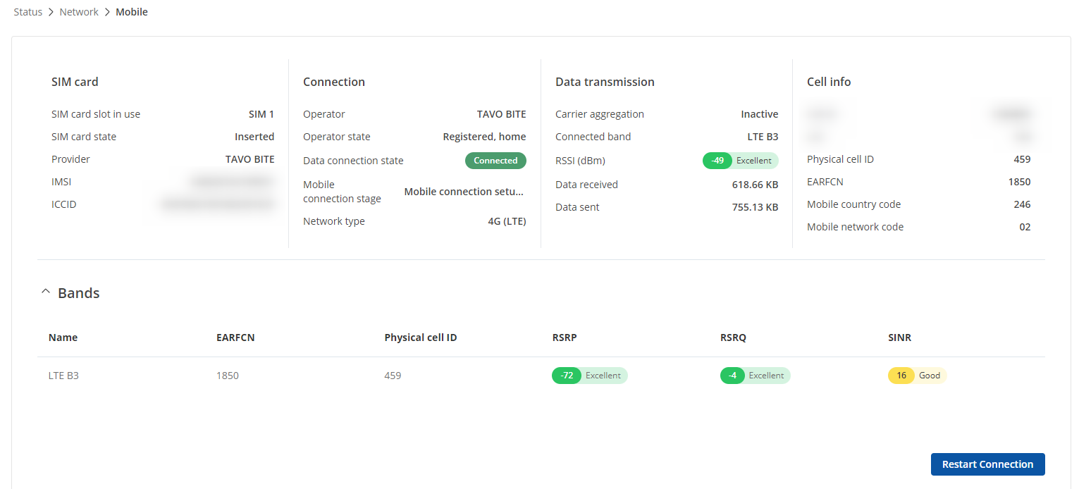

There could be a few factors at play here, but it would be very helpful if you could attach a screenshot from the mobile parameters page of your device (Status → Network → Mobile), with the sensitive details blurred out, similar to this:

As for 5G-only mode, most of the European carriers still use 5G in NSA (non-standalone) configuration, meaning in order to utilize the 5G network, you must authenticate on the network using the 4G LTE technology. 5G is primarily used to increase the bandwidth in this configuration. However, as n28 band is utilizing the 700MHz spectrum, it does not add much bandwidth and is mainly used for increasing the 5G coverage.
As for the speed, could you clarify how the measurements are performed? The most accurate way would be to connect the router to your PC using an Ethernet cable and use online speed testing service. It would also be good to know the actual achieved results of your tests, as the carrier provided figured don’t always match the actual speed figures due to many other possible variables.

Since the n28 band only has 10 MHz channel bandwidth it makes sense that it does not affect the speed much. I would also suggest trying a few different servers from speedtest.net, as Telia server is often at capacity and displays lower speeds than the device is capable of.
