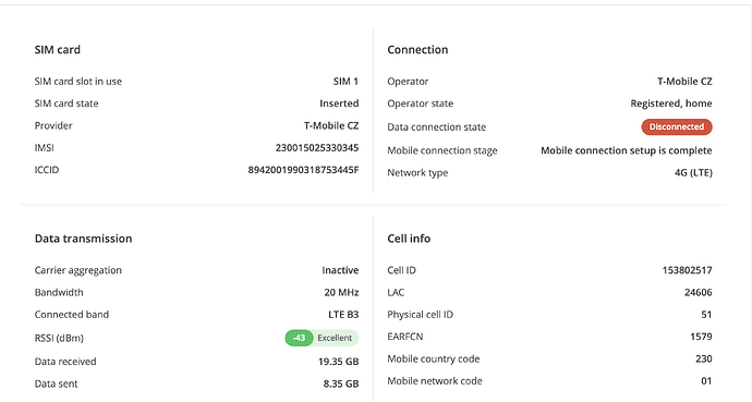

Hello, I often find modem in this state:
Only restart helps to restore connectivity. What to do with it?

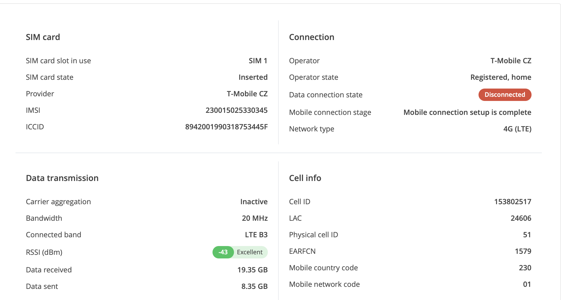

What’s your router’s firmware version (should be latest) and can you post a screenshot of your APN settings as well as Mobile Data where we can see the bands (the screenshot you posted but the part below).
As @TeWe mentioned, there’s likely an APN issue. If you’re using Auto APN but the mobile network isn’t recognizing it, you may need to input the appropriate APN manually. To do this, go to Network → WAN and click “Edit” next to your mobile interface. In the new pop-up window, disable “Auto APN” and choose or input the required APN.

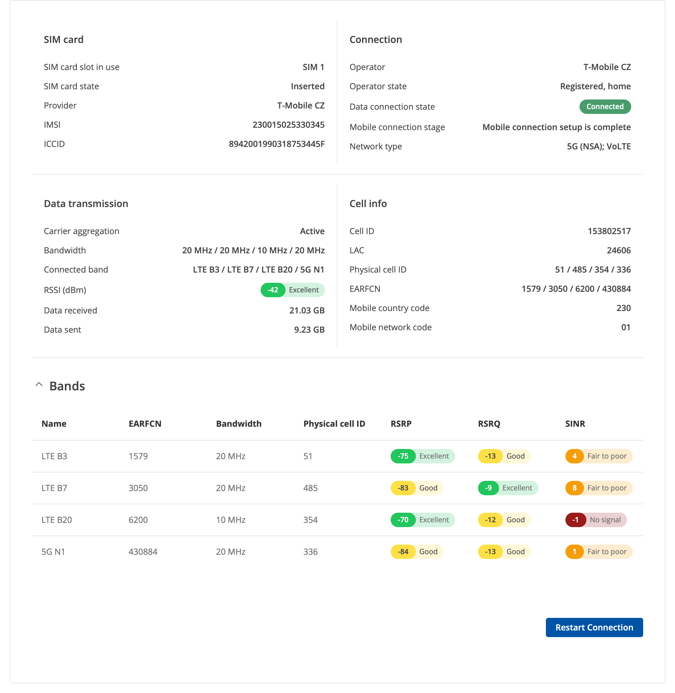

Currently it works:
I will wait until it fail again and then post you the same screenshot. Also will check if APN is the same.
Yes, it looks way better now.

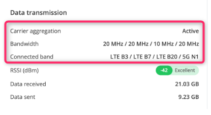

Previously you’ve been on 4G on a single band - now it’s “4G based” (= NSA) 5G connection with carrier aggregation (= more bands bundled together).
And an RSSI value of -42 dBm is really excellent (the lower the value the better).
Good luck that it stays like this!
