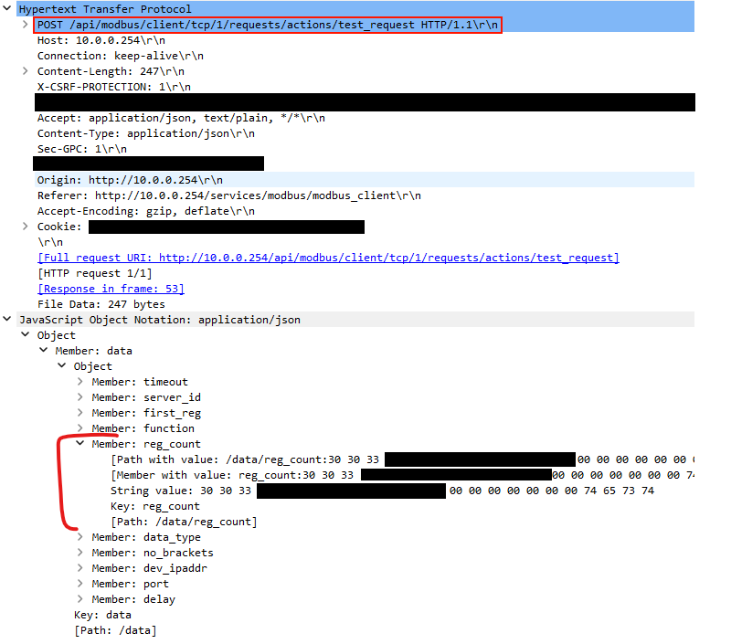

I tried installing tcpdump on the modem to check the modbus request and send it from modbus doctor (a modbus client), but it appears to send a POST request to a specific URI instead of modbus TCP.
I have the feeling that this modbus server just doesn’t work without the modem’s modbus client :frowning:
