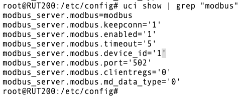

I have a script (python + ssh) to configure the RUT200 router, and now I’m adapting it to enable Modbus TCP communication with the router acting as a server. When I run uci show, I can see that most of the necessary configurations are available, but I’m unsure how to enable remote access using a UCI command.
If this cannot be done via a UCI command, is there another way to accomplish it remotely?

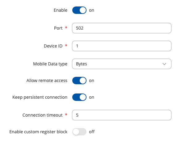

The option for enabling remote Modbus TCP server access is managed through a firewall traffic rule. You can find and configure this rule on the Network → Firewall → Traffic Rules page in the WebUI:

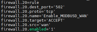

Additionally, you can verify and edit the configuration using the following command:
uci show firewall
