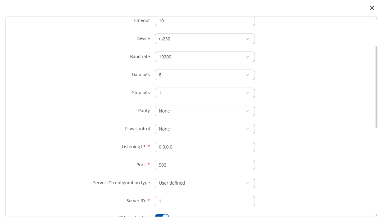

On TRB142 device in TRB1_R_00.07.14.3 firmware I set the “Modbus TCP over Serial Gateway server ID” parameter to User defined. Set “Server ID” field to 1.
It doesn’t work.
It sends the server ID received via MODBUS TCP to the serial port as the slave address and not the set address 1.
It seems like the server id Configuration field is not working properly.

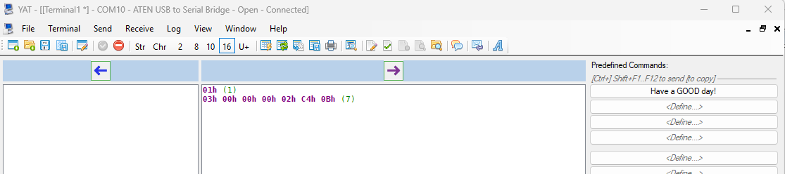

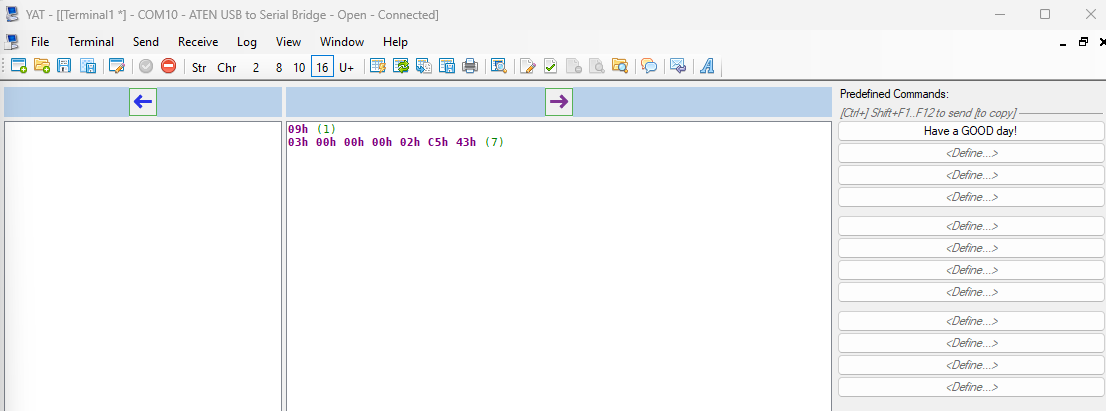

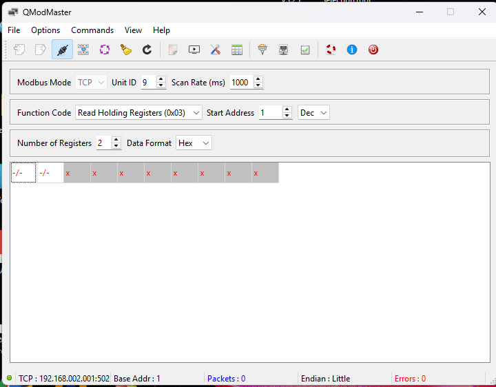

I received the messages on the RSR232 port with the YAT terminal program. I sent the MODBUS TCP command 03 Read Holding Registerts to Unit ID 9 with the QModmaster program. I am reading 2 registers. In the TRB142, I have set it to always send the message to modbus node address 1. The TRB1_R_00.07.13.4 firmware works fine, but the TRB1_R_00.07.14.3 or above firmware is already faulty in the modbusgwd program. You can see in the terminal that node address 09 is sent out on the serial port.
The Modbus RTU device must always send node address 1.
The settings are completely identical in both devices!

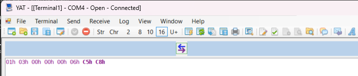

GOOD firmware TRB1_R_00.07.13.4:
The first byte is 01h!
BAD firmware TRB1_R_00.07.14.3 or above:
The first byte is 09h!

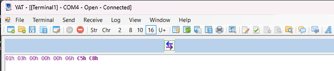

We have tested this setup and were unable to reproduce the issue on the firmware version 7.14.3.
Our testing station was set up this way:
We had YAT run on PC1, while QModMaster was running on PC2 (from it, we sent the data to our PC1):
As you can probably tell, we’re not experiencing the same issue that you are.
