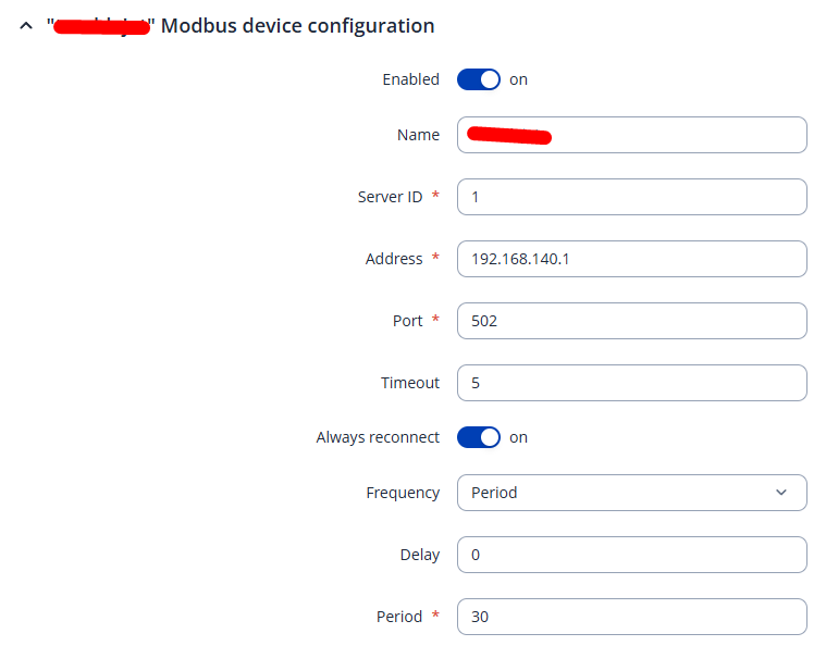

To better understand what’s happening, could you please clarify the following:
  • How exactly are you sending the requests? (e.g., via Data to Server, a custom script, an external application, etc.)
  • Are you seeing any specific error messages or logs when the requests fail?

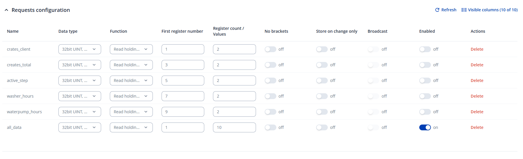

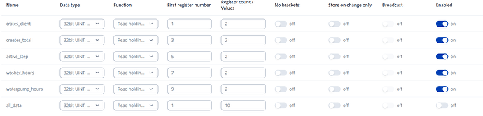

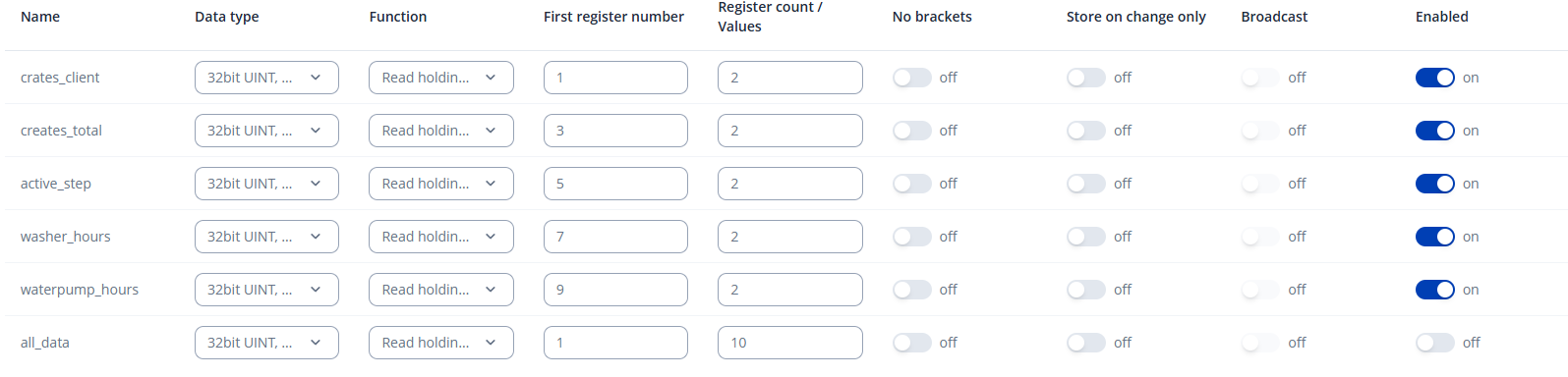

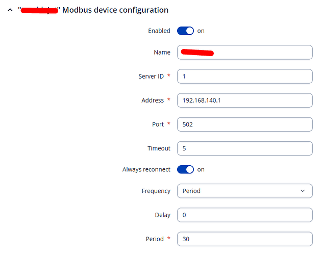

I use Modbus TCP Client to request data from a PLC

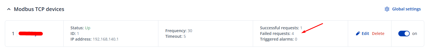

In the above screenshot I request all the data registers in one request. that works fine.
When I want to request the individual parameters (row 1 to 5) I only get the first value (crates_client). The other requests result in a “Failed request”.
Thank you for the screenshots.
To fully reproduce the issue on my end, could you please let me know which firmware version your device is running? Having the exact version will help us continue the troubleshooting more accurately.

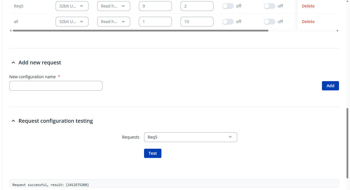

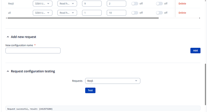

Can you confirm that all of the requests are configured correctly? You can simply test each request one by one just bellow the Add new request section.
Please let me know how it goes,
Warm regards,
Yes, if I test them one by one manually then they work fine.
