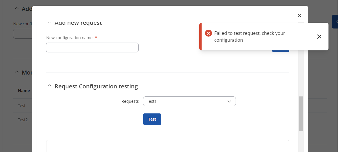

I am trying to write/read values from a deye hybrid inverter using a TRB256, as a RTU Client.
I have set the correct settings and have checked connectivity through a USB to Serial connection.

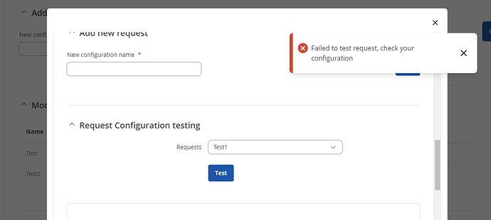

But when testing registers, I i get “Failed to test request, check your configuration”
Do anyone have any tips on how to proceed with troubleshooting?

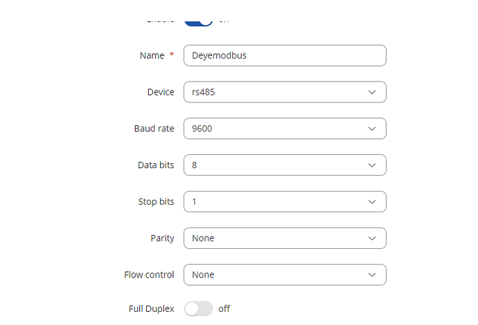

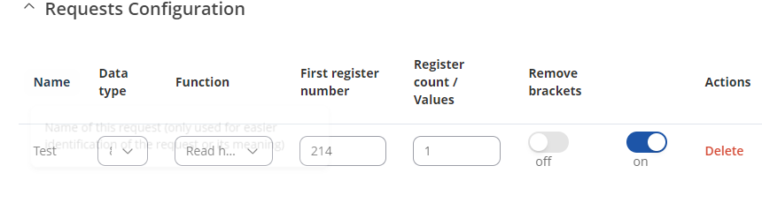

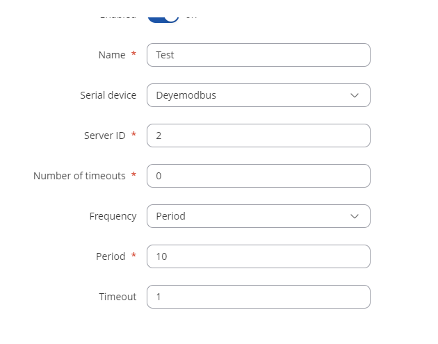

This is the setup:
Register 214 is supposed to be SOC,
