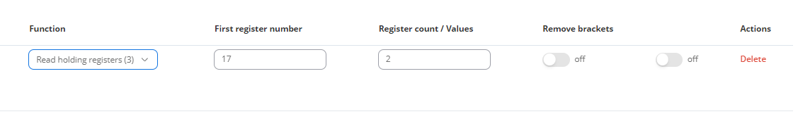

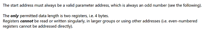

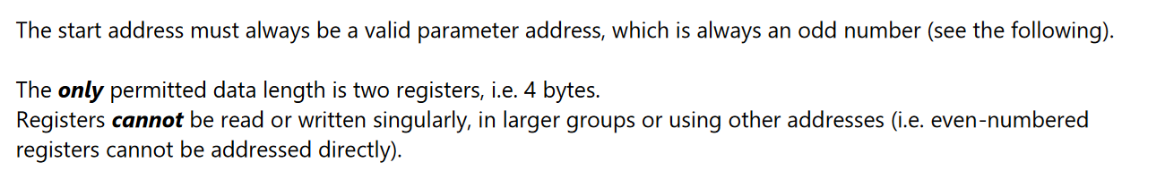

I have a question regards the RUT955. I want to connect a modbus rtu device to the RUT955, in the past I got some problems reading the data this because in all the devices i used there was no option to read 2 registers at once. (This is necessary to read data).
The image above is from the modbus rtu device. Is that possible?
I need to set al the values which are used in this screenshot.
Thanks in advanced!

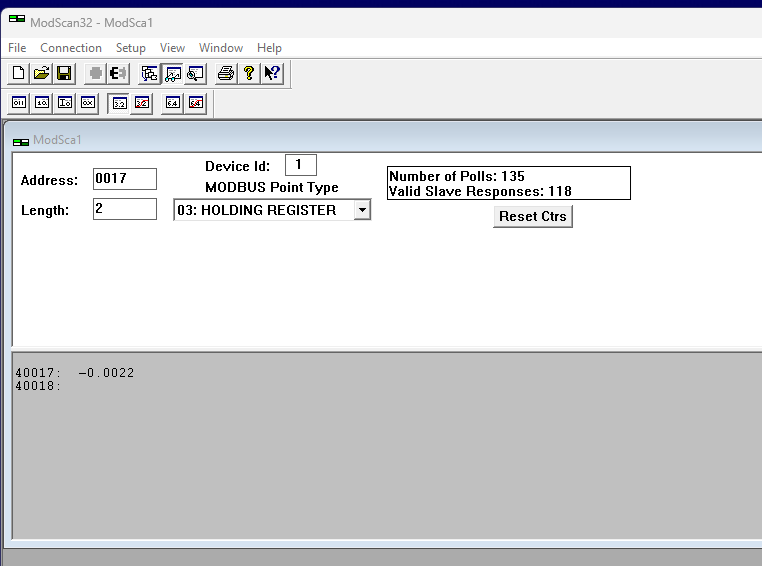

Yes, thats exactly what i want. No problem for the misunderstanding. Where can i set that up? Is it in modbus tab?

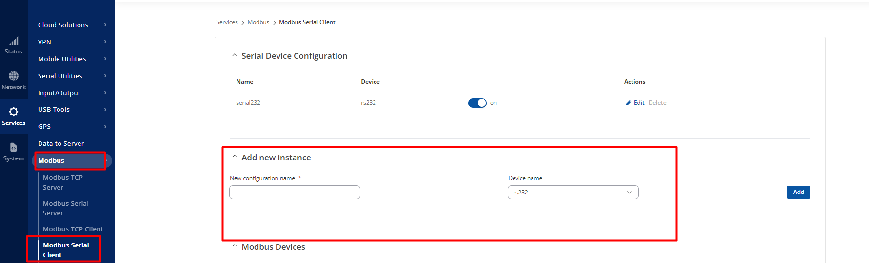

This will be coming under the Modbus Tab , , our device will act as a master and under Modbus Serial Client configuration in Instances, kindly add per the Modbus device specification

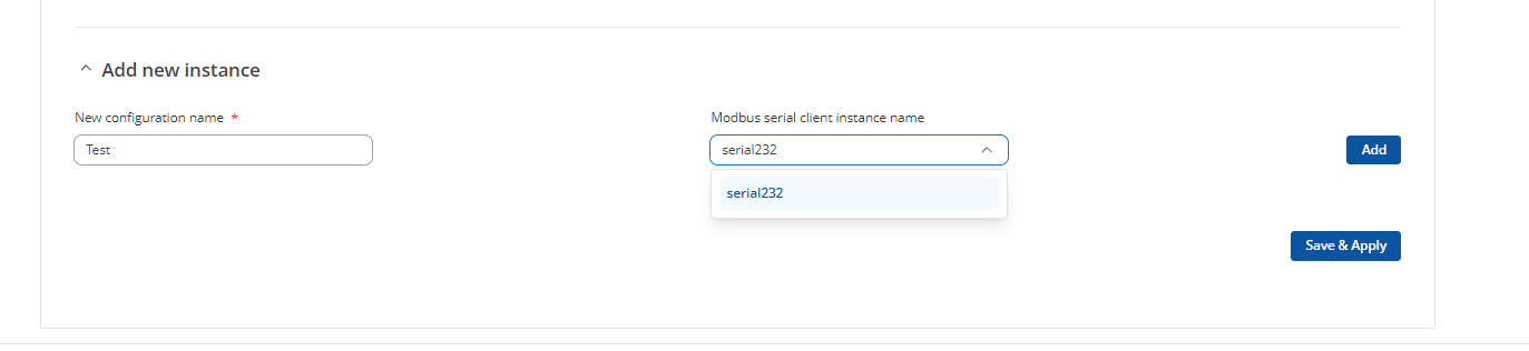

Specify the Serial Type(in my case RS232)

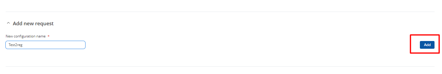

Add a new Instance

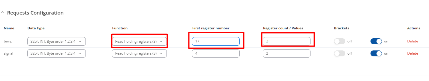

Add the register adress you want to add as a new instance

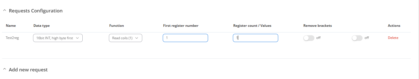

and you may edit the request configuration
should look something like this in your case
Make sure that the data type is set according to the the RTU slave configuration.

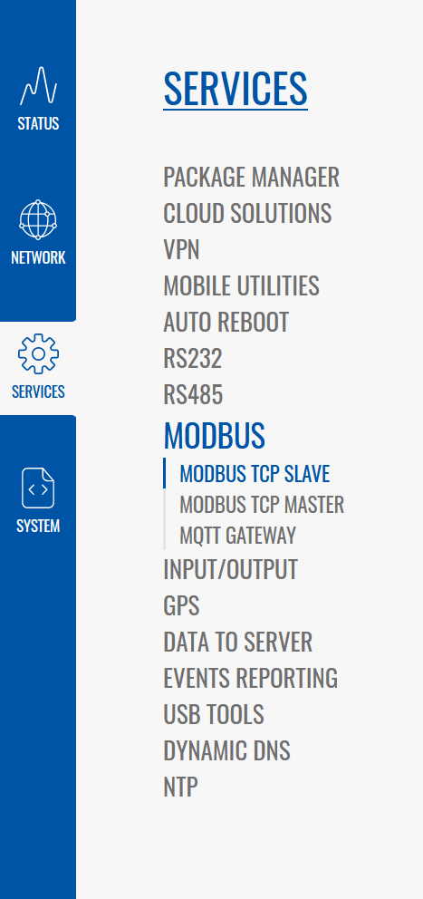

I don’t have the modbus serial client tab, i’m using the Rut955.
Do i need to install something?
I guess you are using an older Fw, kindly would you upgrade to latest Fw
https://firmware.teltonika-networks.com/7.6.1/RUT9/RUT9_R_00.07.06.1_WEBUI.bin
What is the difference between modbus serial server and modbus serial client? Which one do i need to use to read the data from a slave?
The Modbus Serial Server is a device or software that provides data or services in response to requests, while the Modbus Serial Client is a device or software that initiates requests to obtain data or control devices. The client-server architecture is a fundamental concept in the Modbus protocol, allowing for efficient communication and control in industrial applications.
To read from a slave you need to configure the Modbus Serial Client
