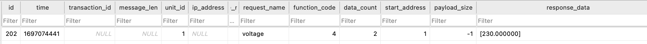

I got from the script:197749.40625
I got from modbus_db: 62.5 (correct one)
May I know if the data is scaled for applied some formula so please tell me the scale factor, then I can fix this problem.

name Value Value
Address, AddressValue: 1 [52922, 0] Value: -1560281088.0 (Need 230.0 here)

Currently, part of the problem is solved, by setting the get_float_dcba(), and address 343-2=341, work,
But, for start adress1, iI dont’t know how to subtract!
Tried many value none of them work.

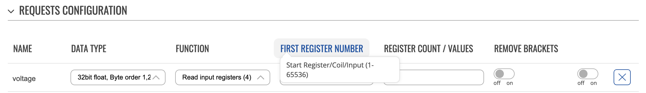

The byte order depends on your devices. It is possible that you need to use a different byte order to interpret the data correctly. So I suggest checking what order works for you.
Keep in mind that RUT/TRB devices use Modbus Register Numbers, while certain third-party devices might use Modbus Register Addresses. The key distinction here is that numbers start from 1, whereas addresses start from 0. So, for instance, if a specific piece of data is stored at Modbus Register Address 101 on the Modbus Slave, you would need to access it from a your RUT956 device by referencing Modbus Register Number 102. So, when using Register Numbers, you would typically add +1 to the Modbus Register Address.
