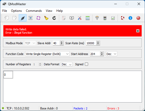

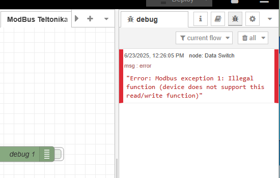

Could you please provide a screenshot showing the error?
Hi Marija,
find below 2 screenshots with the same error; one is from NodeRed, the other from QModMaster.

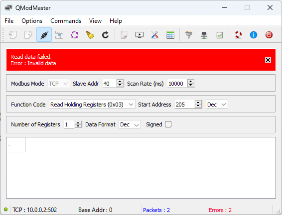

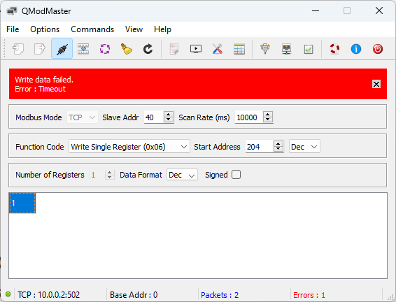

Hi Marija, the illegal function error message is not appearing anymore… but I get very often the “timeout error” and the “invalid data” one when I submit more writes or reads for the registers 204 and 205. See below screenshots.
I also have a considerable number of failed requests I can see on Services-Modbus page.
How can I investigate what’s wrong? I haven’t found any reference to a modbus log.
Would you mind helping, please?
