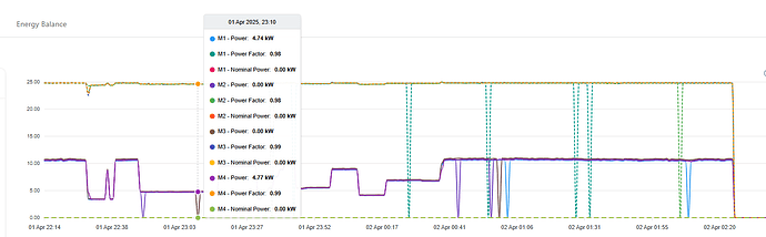

Communication generally works correctly, however, at certain time intervals, one of the requests is failed. (randomly lost). The issue repeats unpredictably —each time a different request is missing.

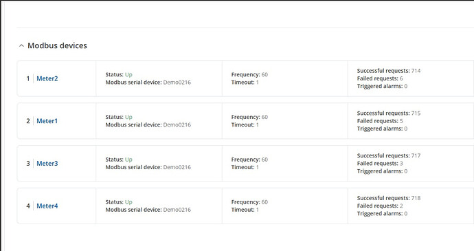

Screen with drops:

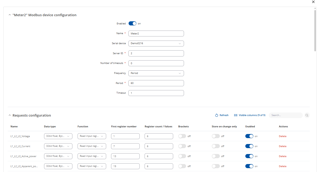

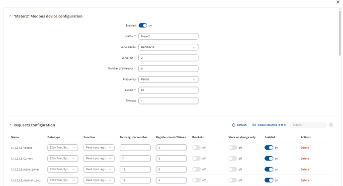

Meter configuration :

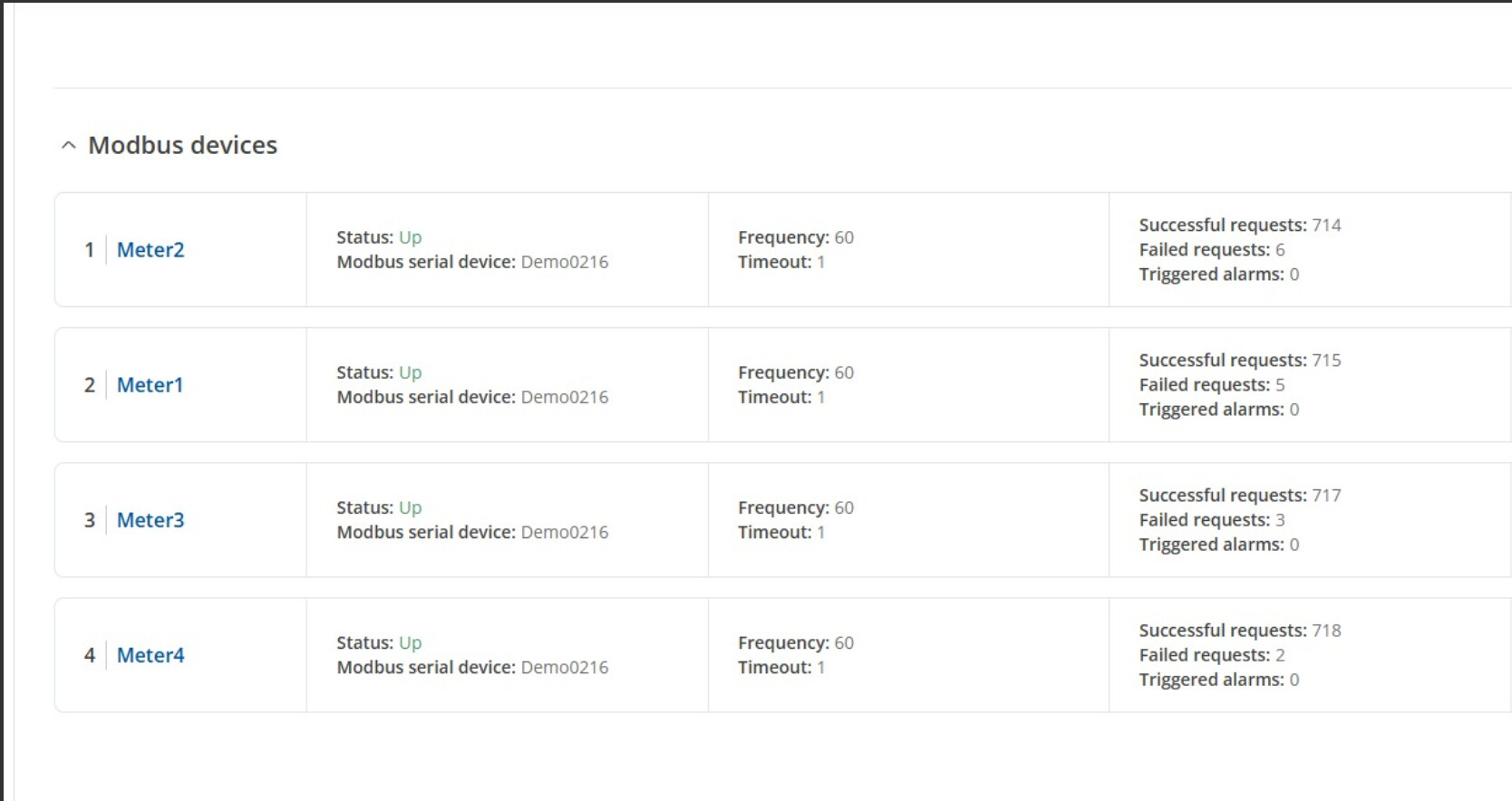

Meters request info:

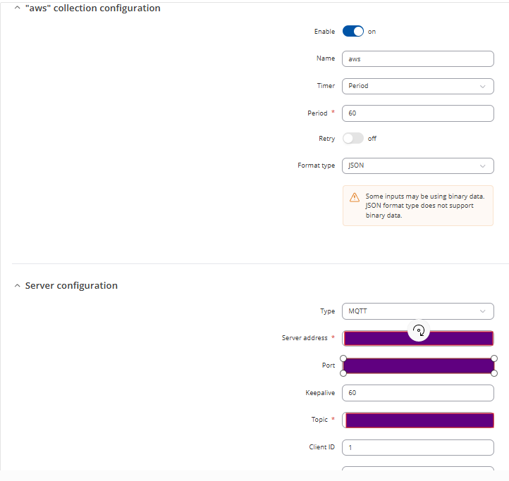

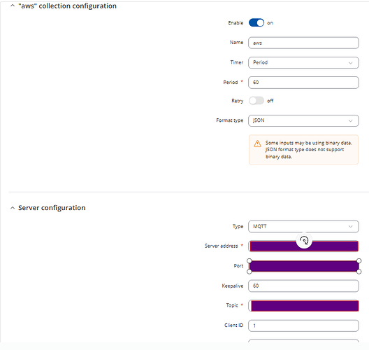

Data to server settings:
