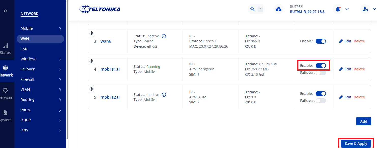

If you have remote access to the WebUI, could you please try disabling the Mobile interface on the Network → WAN page and let me know if the issue persists?

Please disable the Mobile interface in Network → WAN page and press Save & Apply:

Thanks! I did some tests to make sure I can enable it again, and have now disabled it in the web UI + sent “mobileoff” to it. I’ll leave it over the weekend and see what the ISP usage says.
It seems “disable it in the web UI” results in network.mob1s1a1.disabled=1 - is it even equivalent, so it can be done by “uci set”?
It seems “mobileoff” results in network.mob1s1a1.bringup=0 - are they equivalent in the same sense?
