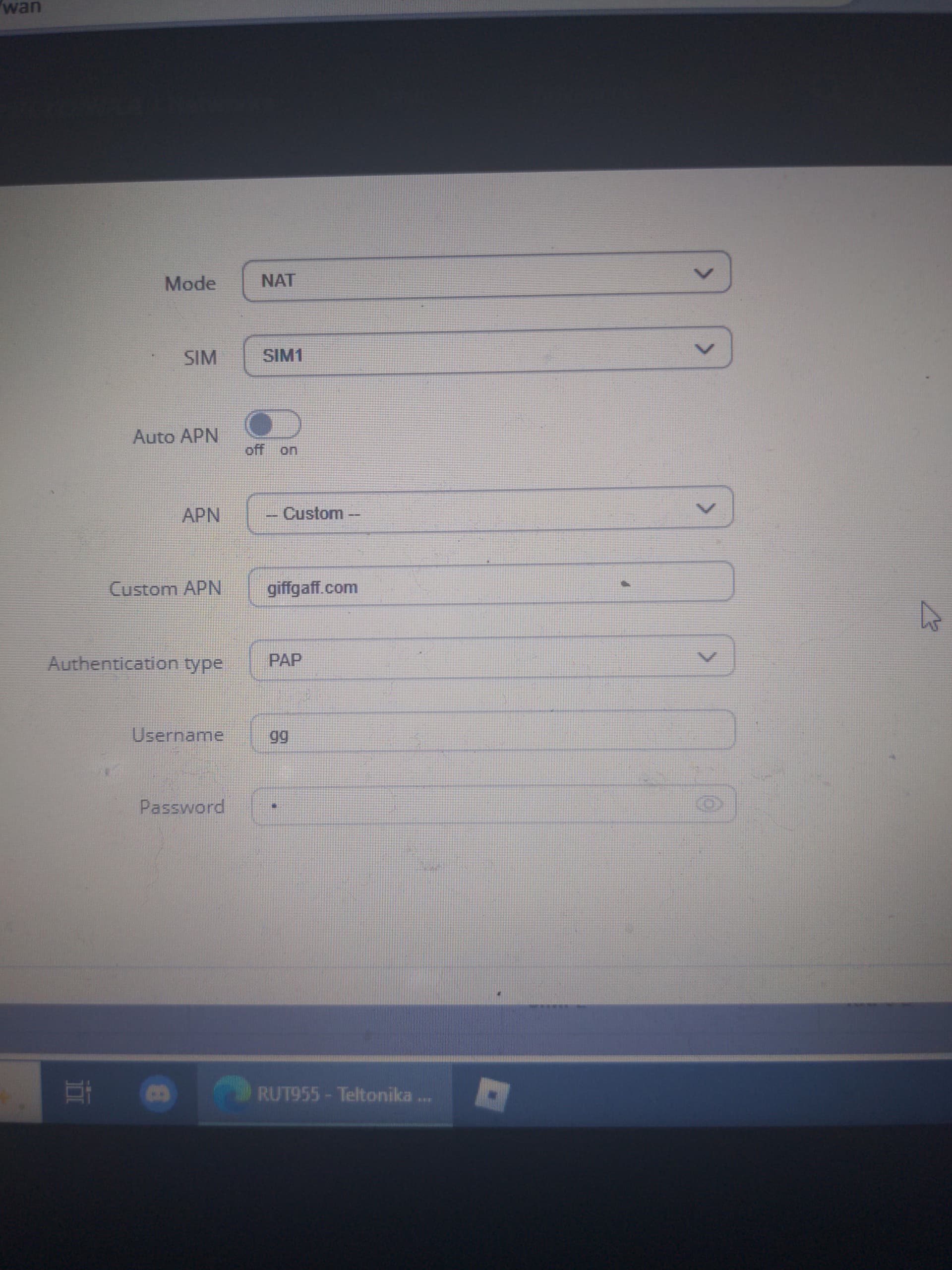

Hi, i cannot get my mobile data to connect, it has found the network but says disconnected, i have updated the firmware, I have also tried to manually input APN details. Also has the new update allowed to connect to campsite wifi with a sign in page?

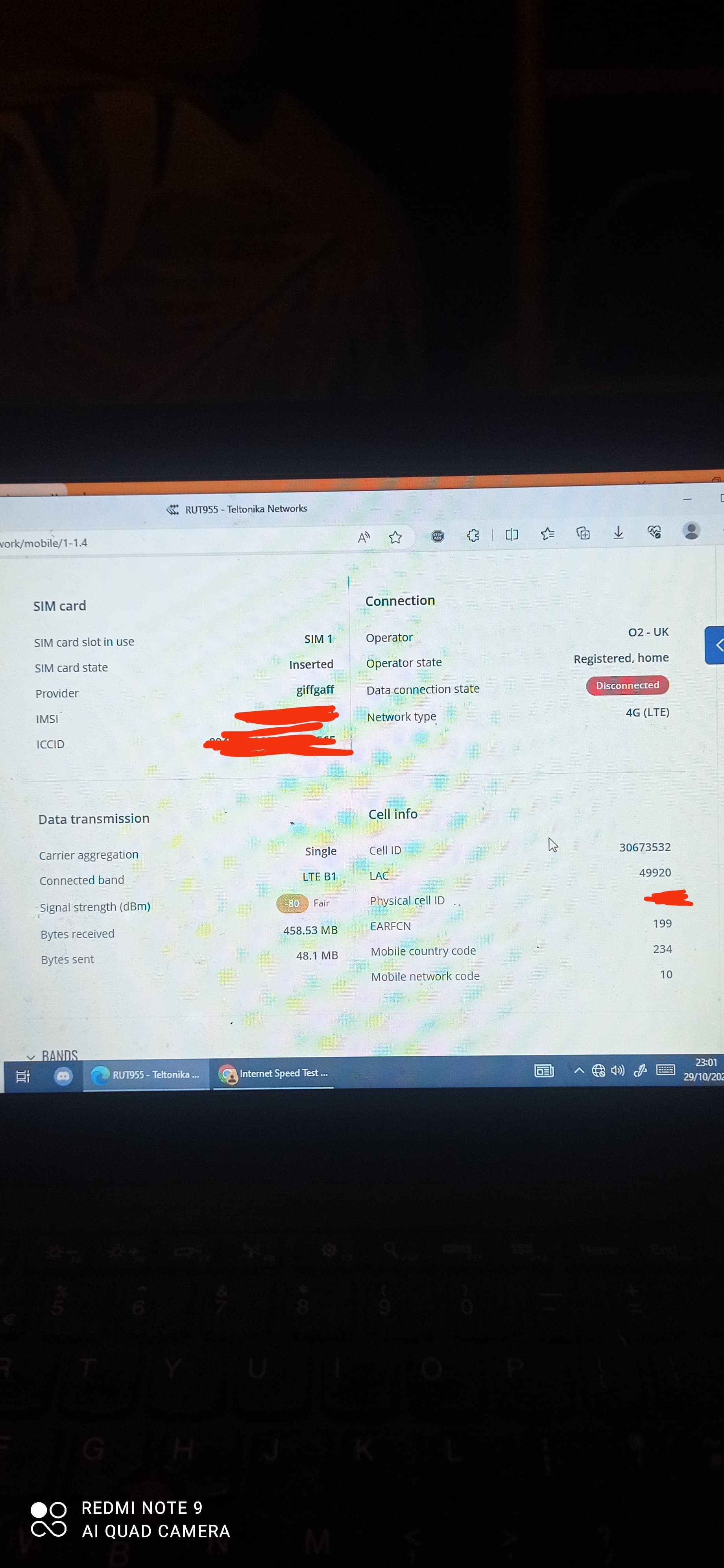

I’d also be grateful if you could attach a screenshot of the Status → Network → Mobile page, as it can also contain quite a bit of useful data. Make sure to blur the IMSI, ICCID, and cell ID values.
Could you also comment of what APN settings you have applied? Perhaps the SIM card needs PIN code to be entered?

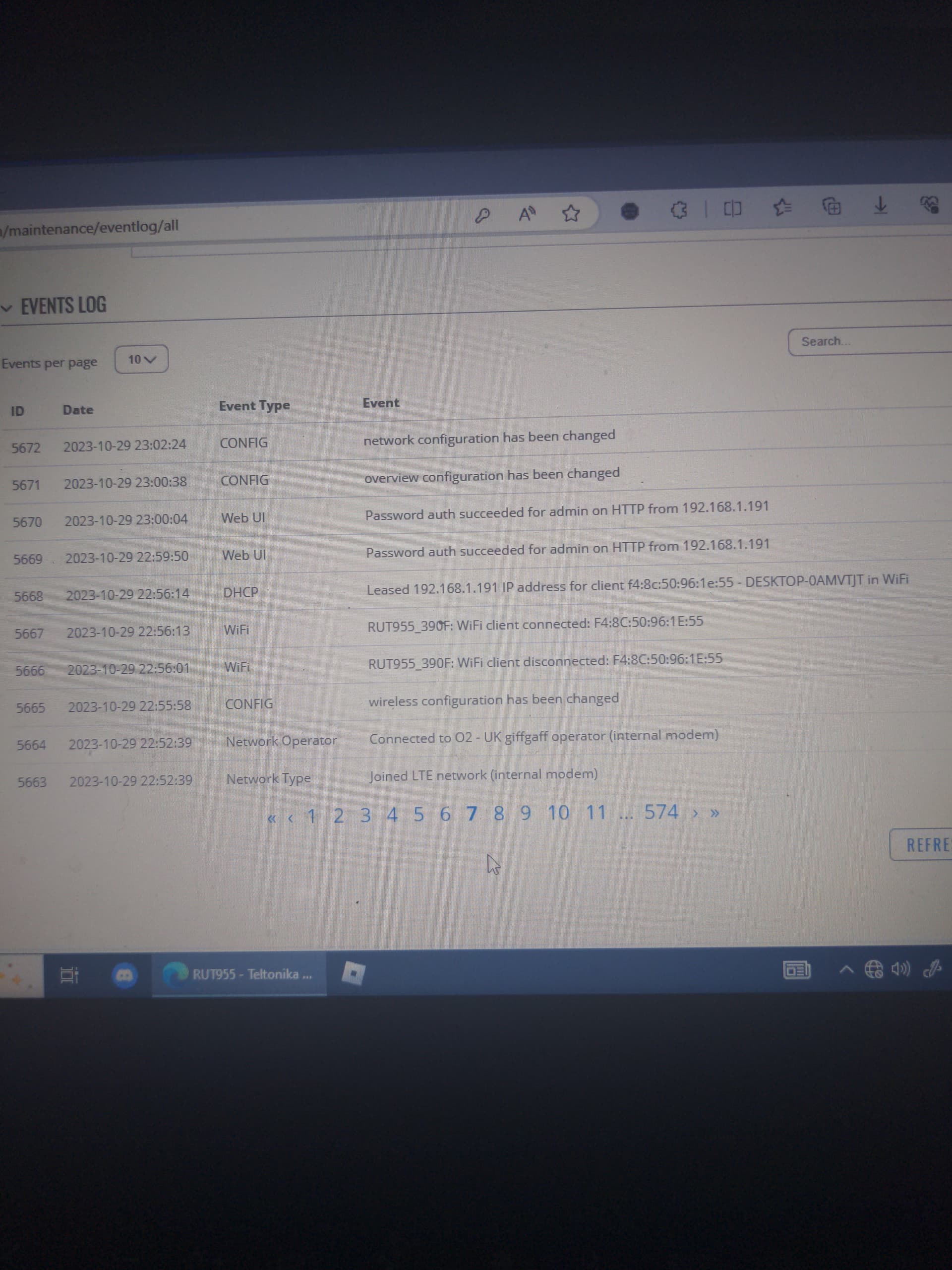

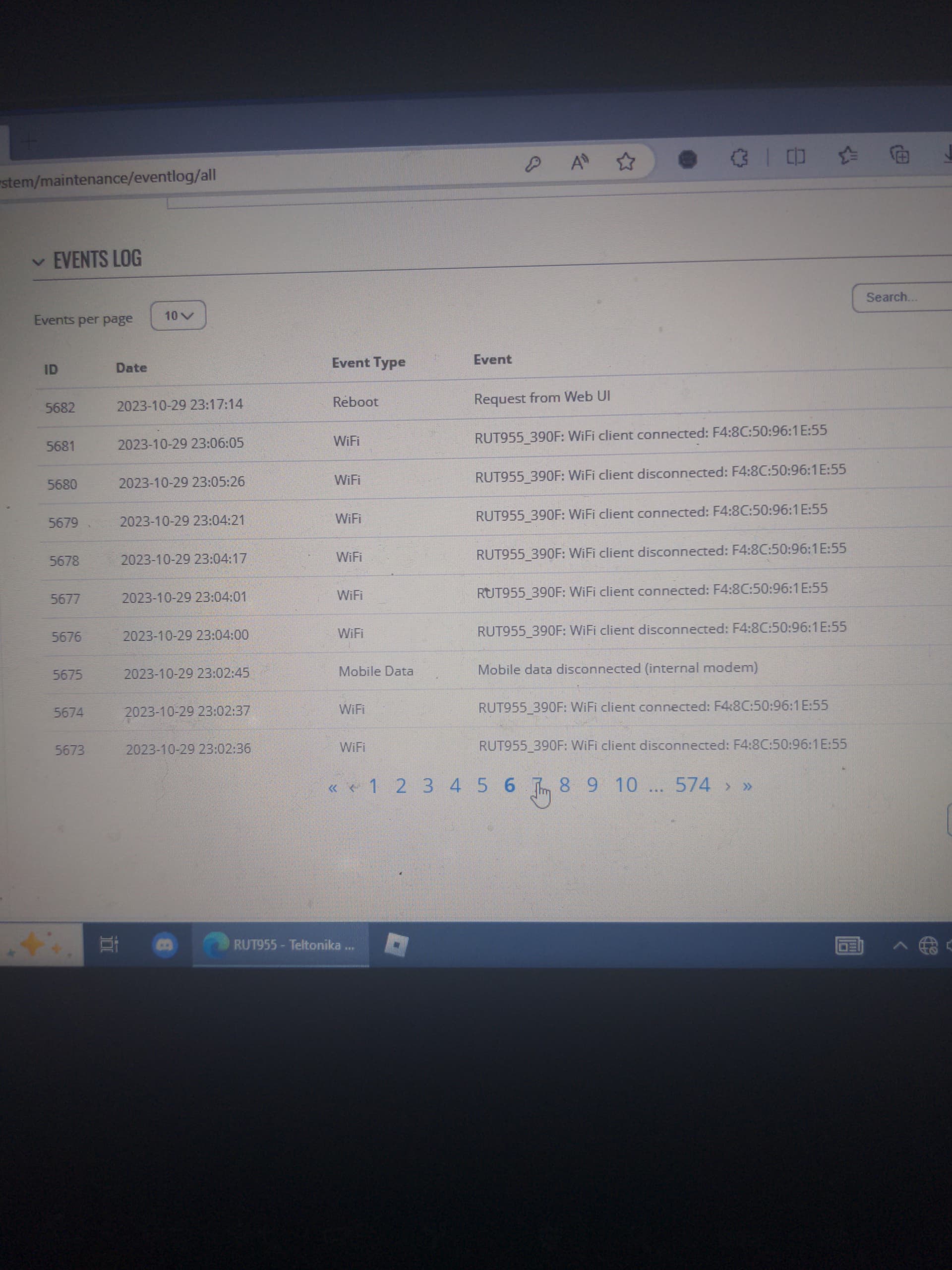

When i switched on my computer today the unit connected for 5mins then disconnected.
I cannot see any exclamation mark in the WAN.
There is no sim card code

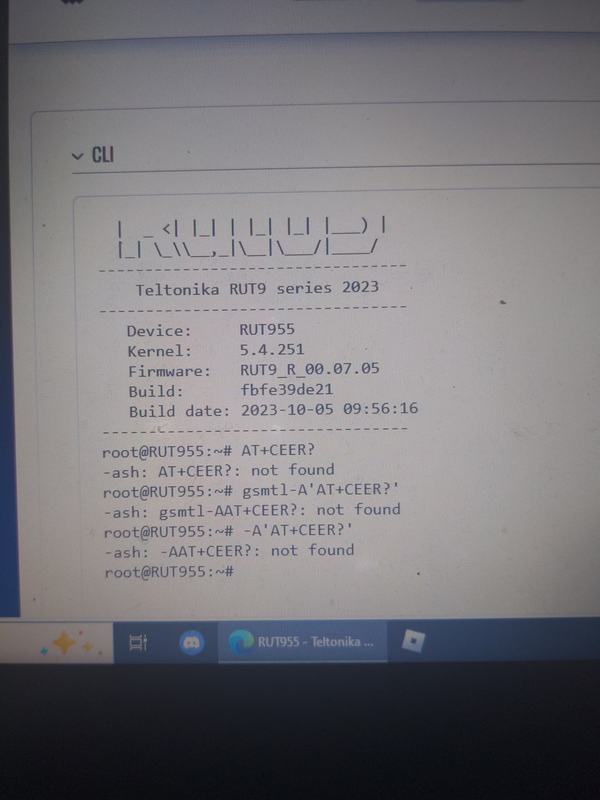

I will ask you to log into the device using SSH/CLI (username root, password is the same as the WebUI), and run the following command:
gsmctl -A 'AT+CEER?'
Post the output in the next message.

Lastly, could you provide the APN that you used when entering custom APN?

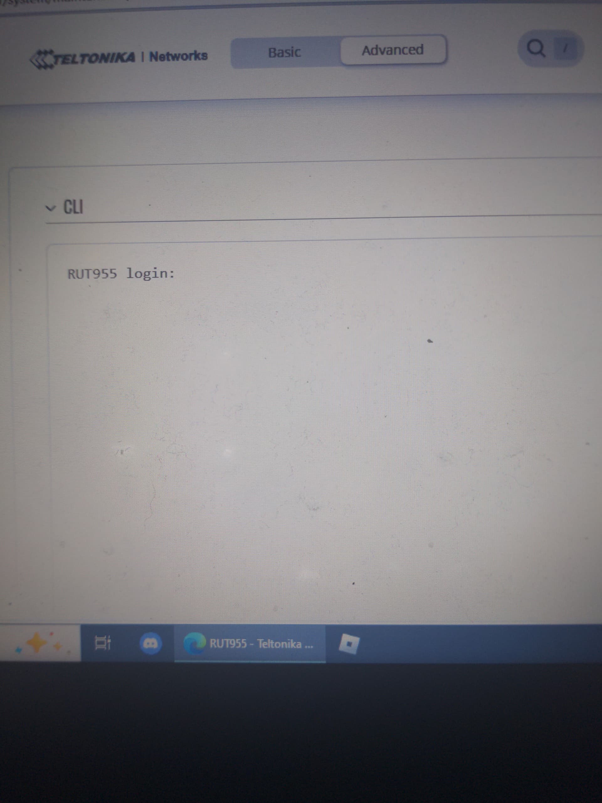

Please can you explain how to log into cli? Is it in the advanced settings?

APN
Am I doing something wrong? Thanks
It should be gsmctl -A ‘AT+CEER?’
Make sure to run it after replicating the issue.
Hi, i am not knoweladge enough to understand with out step by step instructions or pictures regarding this, i would like to get the router working as we have owned for 2 years and it intermittently worked initially and now wont connect at all, i appreciate your help and speedy responses.
