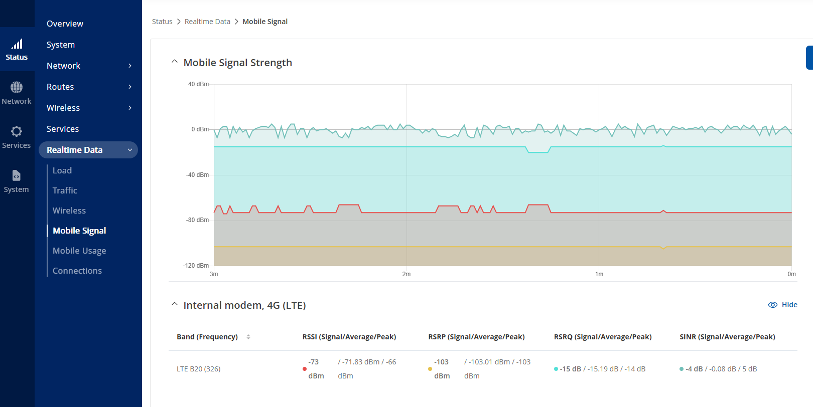

Looking at RealTime data and especially the RSRP number that is -103dB leads me to believe that we have some kind of signal problem.
Very well looks to be the case. Since it looks like you’re connected to the B20 band and it provides such weak signal strengths, could you try locking onto different bands to test to see if those provide better signal strengths? Here’s a guide on band locking: Band Lock - Teltonika Networks Wiki
This part specifically is what caught my eye, since you are in central Stockholm, it is very likely that the specific B20 (maybe some other band as well) is being used by a lot of different devices around the city, naturally making it less of a good option to use.
