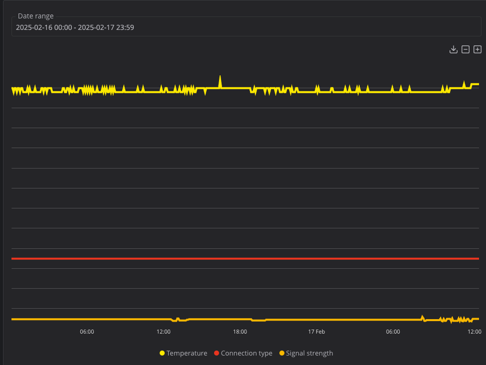

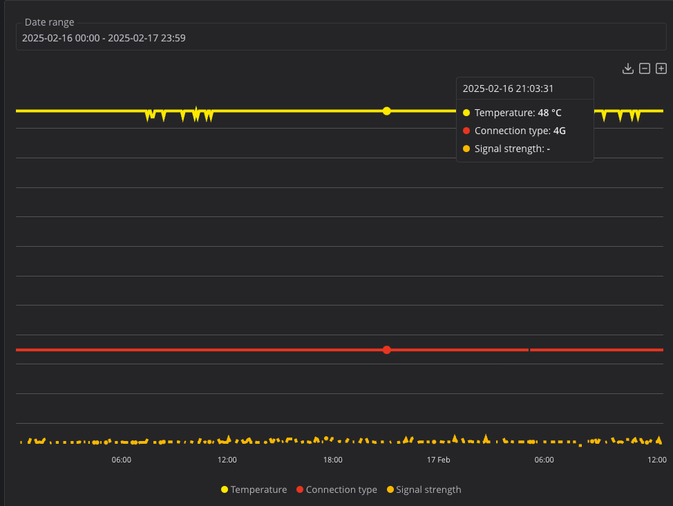

Hello Community. We have noticed that both when polling the Teltonika API and when looking at the Teltonika RMS Dashboard we have missing data points for the signal strength of the GSM connection.
We find no correlation between Router software version (we run RUT955 with versions RUT9_R_00.07.06.16 and RUT9_R_00.07.06.17), modem model… and we do not see this affecting the connectivity of the devices connected to the router.
Also, this happens to most routers in our fleet but not to all.
Is this a bug, or actually reflects something?

Hello Martynas,
Thanks for your answer. We have easy access to two routers so I run some tests but no improvements:
  • Both Routers are situated in the same room and have good internet connection.
  • Both are running the latest software for the OS and the modem.
  • Both run the same image configuration
  • One reports the signal in a continuous mode, the other has holes in the graph.
I have switched the antennas between them, and replaced the antennas of the faulty one with new ones, but the situation is still the same.
Maybe I’m missing some configuration?
Kind regards
