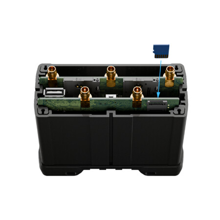

Regarding the SD card slot, RUT956 routers manufactured after Q3 2024 do have one, but it is an internal microSD card slot, so you will need to open the device by removing the back panel and pulling out the PCB board to reach the SD card socket. Please make sure the device is powered off when you are disassembling it.
Here you can find instructions on how to insert the SD card and the compatibility requirements: RUT956 SD Card - Teltonika Networks Wiki

After reviewing the serial number you provided, we can confirm that your RUT956 device was manufactured prior to the implementation of microSD card support for this model. As a result, the device does not include a microSD card slot.
We apologize for any inconvenience this caused. For more specific information regarding your order, we recommend reaching out directly to your supplier, as they may be able to provide additional details based on your original order.
Here you can find more information of when the changes were implemented: RUT956 Product Change Notifications - Teltonika Networks Wiki
