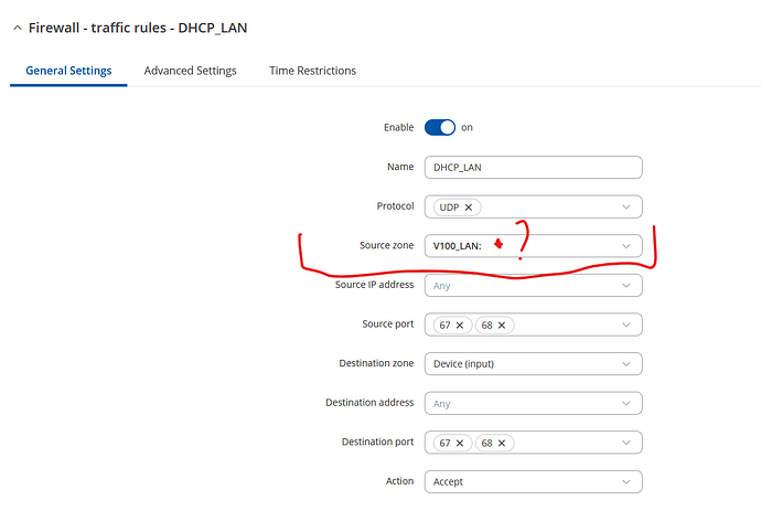

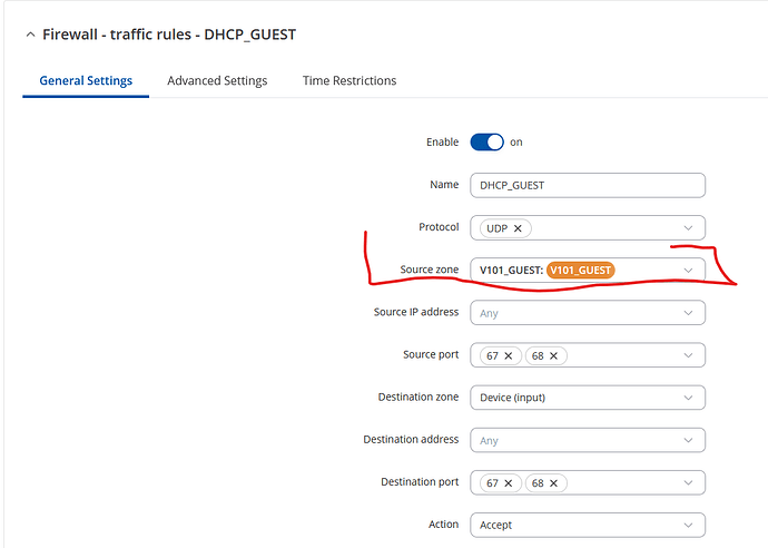

I’m not sure how to title this topic, so please excuse the slightly chaotic approach. :blush:
Could you take a look at the pictures and let me know what I might be missing? What should I add to /etc/config/firewall, /etc/config/network, or any other file to make everything appear consistent?
Perhaps I didn’t add vlan100 in the same way as vlan101, or maybe there’s an issue with the zone configuration, or something else I’m overlooking. While the configuration works perfectly fine and behaves as expected, I’m puzzled why this orange-colored description isn’t showing up at all.

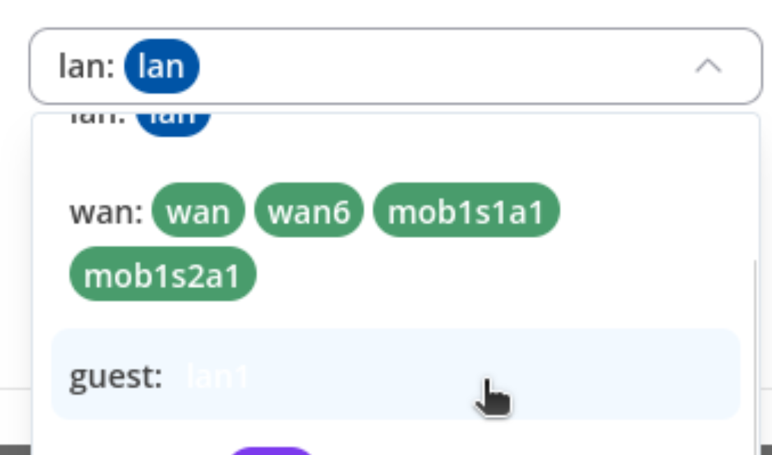

Did you assigned any networks to this zone?
  • If not - this is your problem.
  • If yes - try to click on select and hover this option then you might be able to see networks name very dimly
If the latter true then it means that everything is ok and it is just a visual bug that it is already known.
