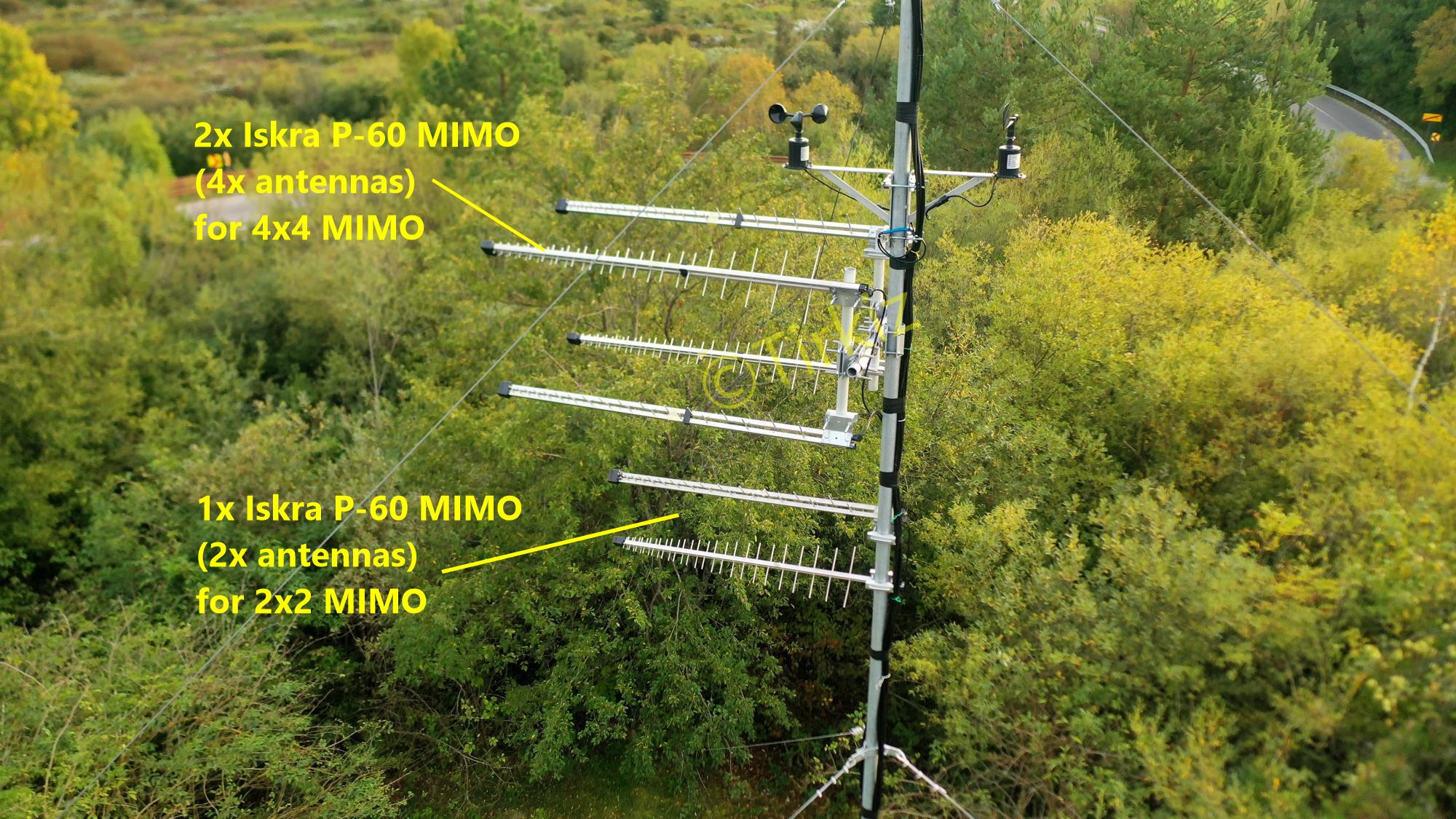

I use Iskra P-60 MIMO antennas, they cover all 4G/5G frequencies and are the best.
If your tower has 4x4 MIMO which means 50-75% higher speeds, you need to buy another pair of Iskra P-60 MIMO (4 antennas in total and mount them correctly and pay attention to the spacing between the antennas, eg I use 34 cm between antennas for B3 band as the golden mean).
These antennas must be as high as possible and pointed at the tower for the best signal and speeds (if the tower is not loaded).
