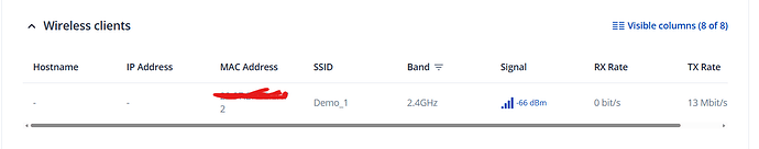

Now the problem we’re facing is that it seems like one of the RUT956 manages to connect to the gateway(RUTM11) as shown:
But we can’t actually manage to ping it from a windows PC connected to the LAN port on said RUT956.
SOme extra info:
The RUT956, the RUTM11 and the windows PC all have static Unique IP addresess on the same subnet.
All routers are running firmware 7.18.3
THe SSID acting as mesh, has got the Network setting to LAN.
We’ve also tried setting up a Static route but that didn’t help
Any sugestions as to why we’re unable to connect to the RUTM11 via the mentioned RUT956?
A different RUT956 on the same mesh network does manage to connect to the RUTM11.
