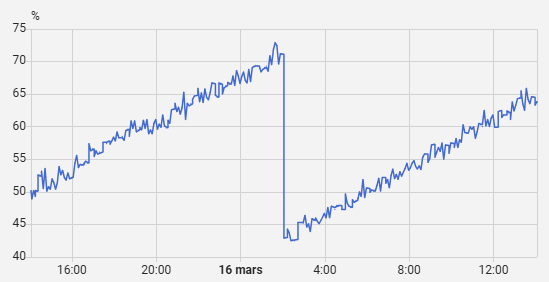

Since I started to use http requests from Node Red (via the API) RAM usage started to increase until all slowed down and I could not log in to the unit. A hard reboot brings the system up again but the memory leak continues. My temporary fix is to have scheduled reboot every day at 03:00. When I disabled the http requests memory leaking stopped.

The response from the router was fast and consistent but as I wrote the memory leakage jammed the router.
