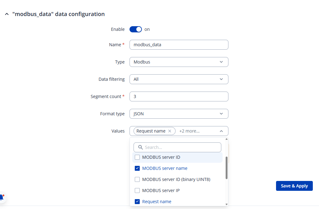

When we select JSON as the format type, we are allowed to add multiple fields to the JSON object, including Modbus Server name and Request name. This information tells us about the origin of the information (Modbus slave), type of data, etc.
Without this, we only see a bunch of bytes arriving at the formatter, impossible to know how to parse them except maybe for the data length.
Problem solved. I simply used the default Lua script returning the whole JSON data object and I’m now able to see all the available fields, including timestamp, server name, request name, server id, etc. Everything we need is in the data object.
