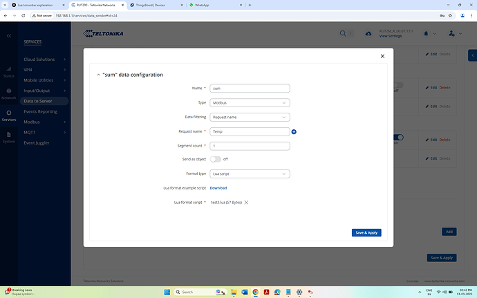

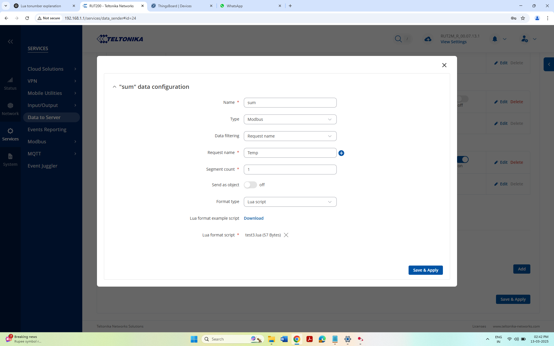

I want to upload my plc tags coming via modbus tcp to mqtt by data to server section i also want to add some offset in it so i want to use lua script
but by using following script i am not getting data uploaded on mqtt
In data configuration:
Type: Modbus
Format type: Lua Script
script is: local tag1 = tonumber(data[“Temp”])
local sum = tag1 + 5
In collection configuration:
again
Script is: { “sum”: “%=return sum%” }
but no data is uploaded to by mqtt platform

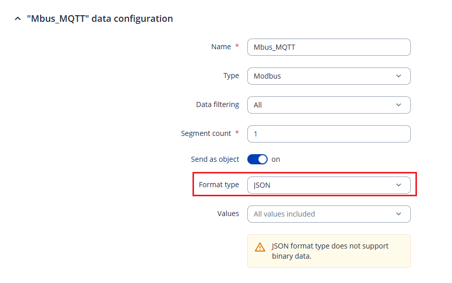

I still can’t get it to work. Let me show the details of what I am doing:

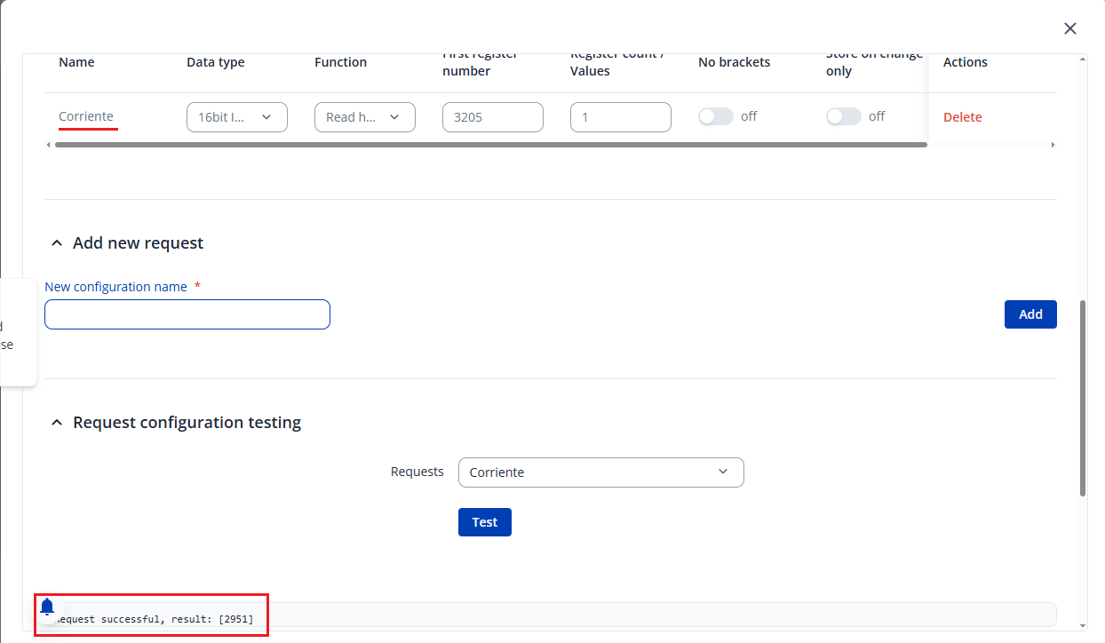

  1. I have a Modbus client reading succesfully. It has a variable named “Corriente”, as you can see in the picture.

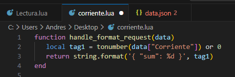

  2. I created a Data to Server instance with a Lua script format type with the following very simple code trying to read “Corriente” tag and formating it with my own JSON:
function handle_format_request(data)
local tag1 = tonumber(data[“Corriente”]) or 0
return string.format(‘{ “sum”: %d }’, tag1)
end

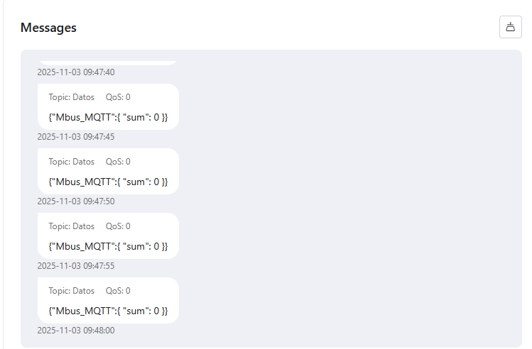

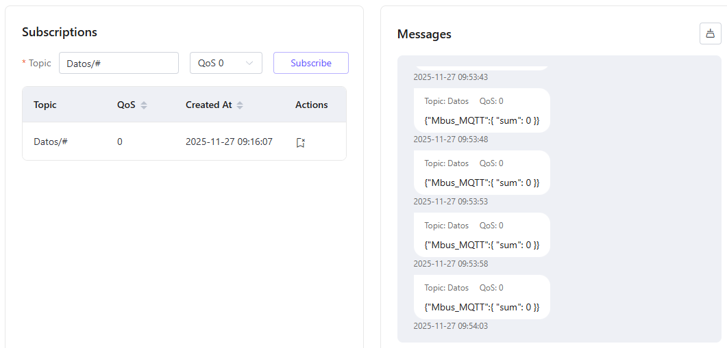

  1. It looks like the code is not catching the value of “Corriente” from the tonumber(data[“Corriente”]) because in the MQTT broker shows the value of zero (0)

Could you please share a screenshot of your actual lua script/plugin, because from the text code you shared, it looks like the quotation marks used for "Corriente" are not plain ASCII quotes but “smart” quotes (“ ” or ‘ ’). Lua only accepts standard straight quotes, otherwise, the variable won’t be recognized correctly.
Good day,

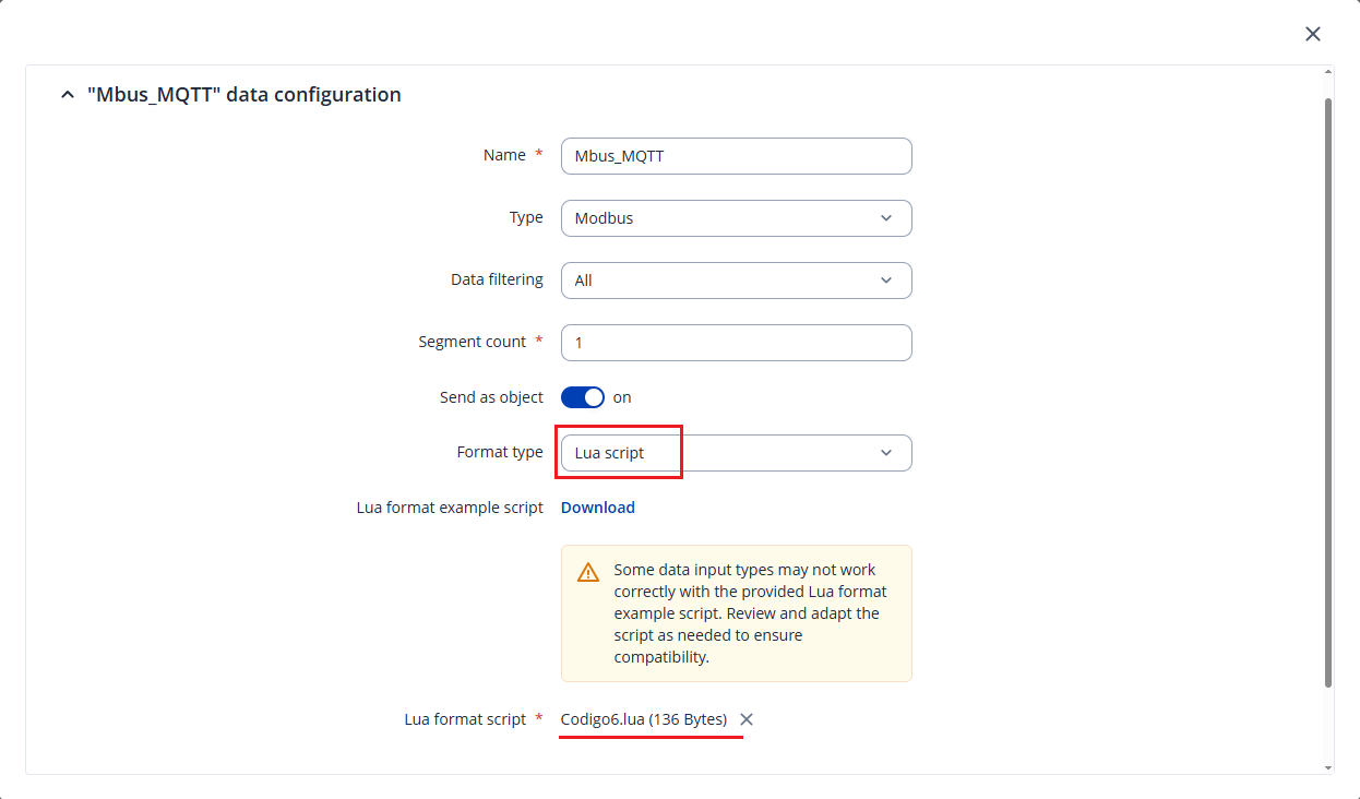

Yeah, in fact it had the wrong quotes. I fix them but it still does not work. Here is the screenshot of the new code (I put it on visual studio code so we can validate the quotes):

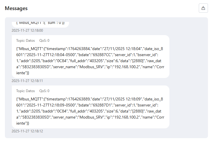

In this case, I am still getting the “0” value on my MQTT Broker as you can see in the following screenshot.

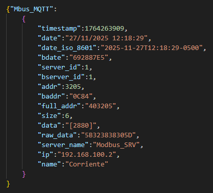

In case you need the following information: if I use the default JSON format, this is what I get on the MQTT Broker:
Fixing it in visual studio code:
