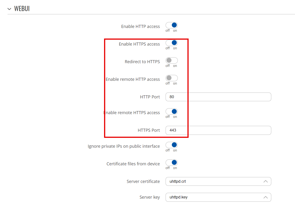

I’ve managed to lock myself out of the webui (RUT241). I beleive I enabled HTTPS access and turned on Redirect to HTTPS. I had remote access working just before this via normal HTTP, local and remote…
Have tried different browsers and incognito mode… I get “This site can’t be reached”
I can’t get to the webui locally either anymore. Is there anyway I can un do these changes via SSH? I still have access to it locally and remote via SSH…
Please help thanks!

Hi thanks for the reply,
Are you able to tell me the specific command to disable redirect to https?
Thanks!!!
To disable redirection to HTTPS, you can use the following uci command:
uci set uhttpd.main.redirect_https='0'
uci commit
/etc/init.d/uhttpd restart
# you can view uhttpd settings via:
uci show uhttpd
Thanks!!!
That worked :slight_smile:
I’ve regained remote web CLI access :ok_hand:
