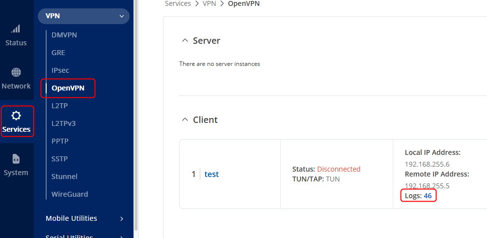

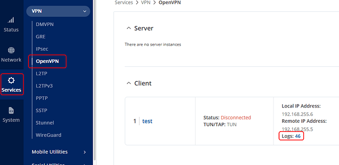

What I’d like to see is logs from the OpenVPN client:
Make sure you blur out any public IP addresses, MAC addresses and such.
Specifically would need logs right after the device disconnects and attempts to reconnect.
