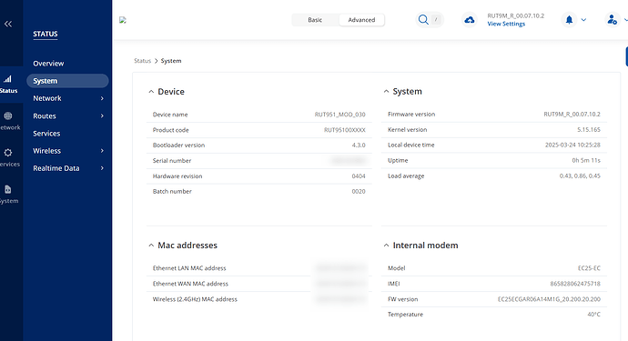

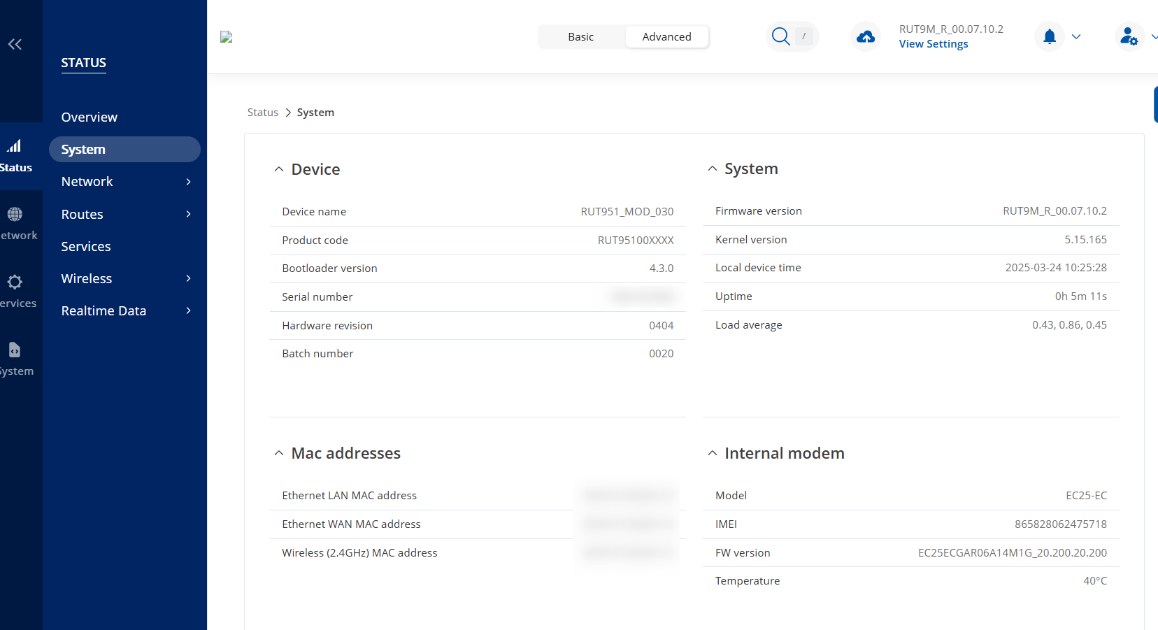

Great !
It works (event if some icon are still missing ?? :slight_smile: ) by just deleting the menu.json
No perhaps I can proceed to an updgrade : just I note that HW revision is 0404 : the first one I see.
Thanks and BR
